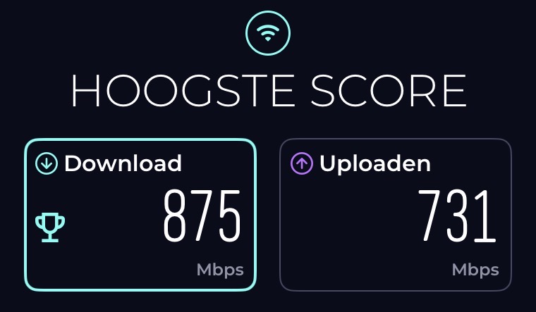

FRITZ!Box (manufacturer AVM) is the leading provider of routers for home users in Germany, with a market share of around 50%. The brand has dominated the market for years thanks to its high user-friendliness and technical performance.
In my experience, the manufacturer’s support is very good. They were very helpful when I switched to a new fiber optic provider and encountered problems, and even created a special version for my FRITZ!Box to resolve issues with my landline phone connection over fiber.
This is my second new FRITZ!Box in 14 years, currently with 30 devices connected via Wi-Fi (four on 5 GHz, the rest on 2.4 GHz), and I’ve never had to manually restart the box (not even the previous one). I don’t think the problem lies with the FRITZ!Box itself (though it’s possible). However, the Zigbee support on my new box isn’t great (it only supports a very limited number of devices).

Glad you are having a good experience with it. Many people don’t. Perhaps because most people in Germany have them that isn’t surprising.
