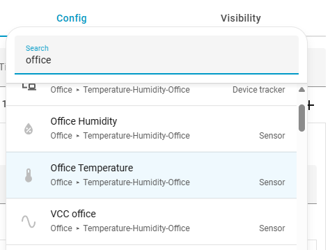

EDIT: I may have fixed it, i went to the esphome integration and saw this one board being in there twice, with exactly the same name and IP, i deleted one, pressed reconfigure on the other and now i see it again. Not sure how that happened, I have had that sensor for years.
For a few months I have something weird. One of my temp and humidity sensors is not working anymore in my dashboard (The entity is greyed out), but if I open it through esphome it is up and running and sending data. Neither temp or humidity sensors work in my dashboard. In the past I had some success with restarting my pi which runs HA, but today that did not work. I have also moved the sensor to a new location, thinking maybe it had a bad signal but that does not appear to be the case either

    I thought about recreating the entity but it is greyed out (see picture)
