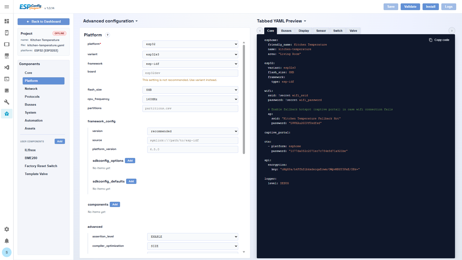

  • visual Builder based on JSON schemas
  • live YAML preview

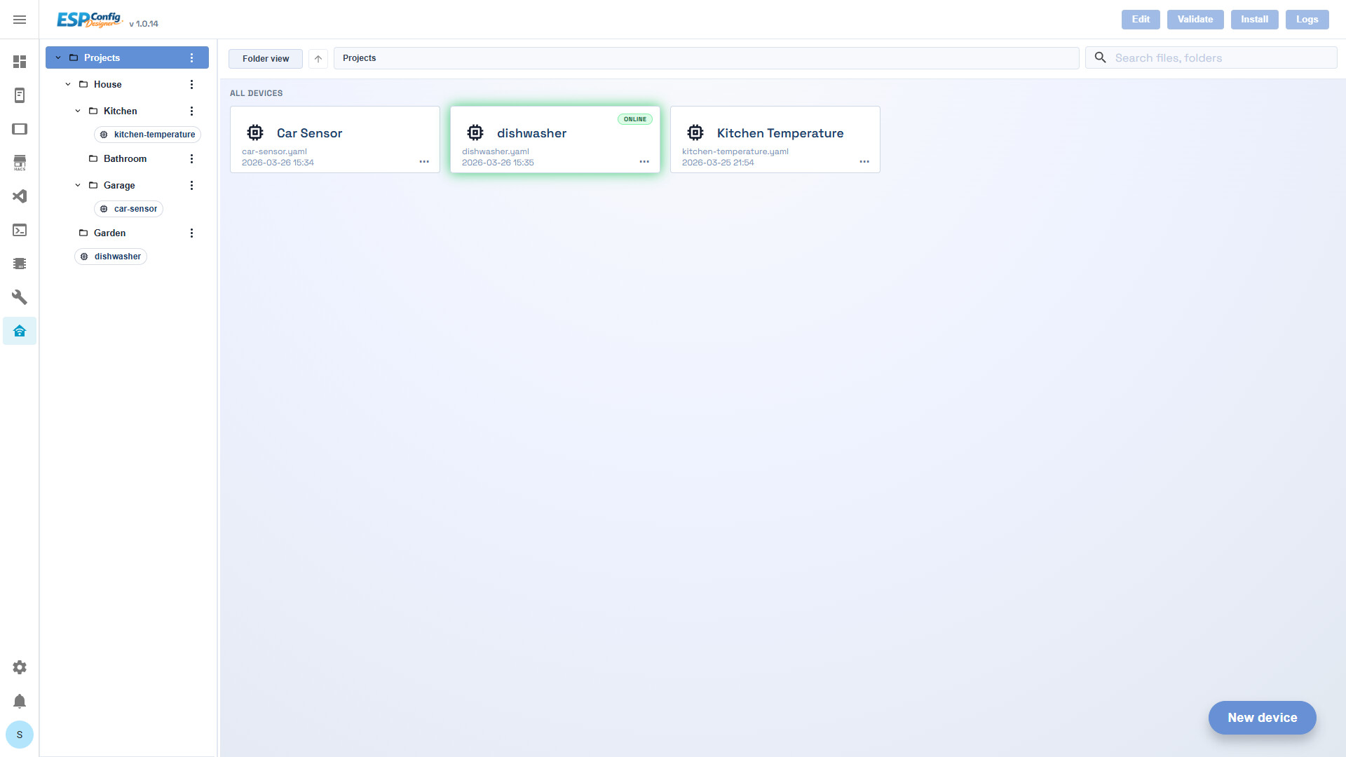

  • project dashboard with folders and device status badges

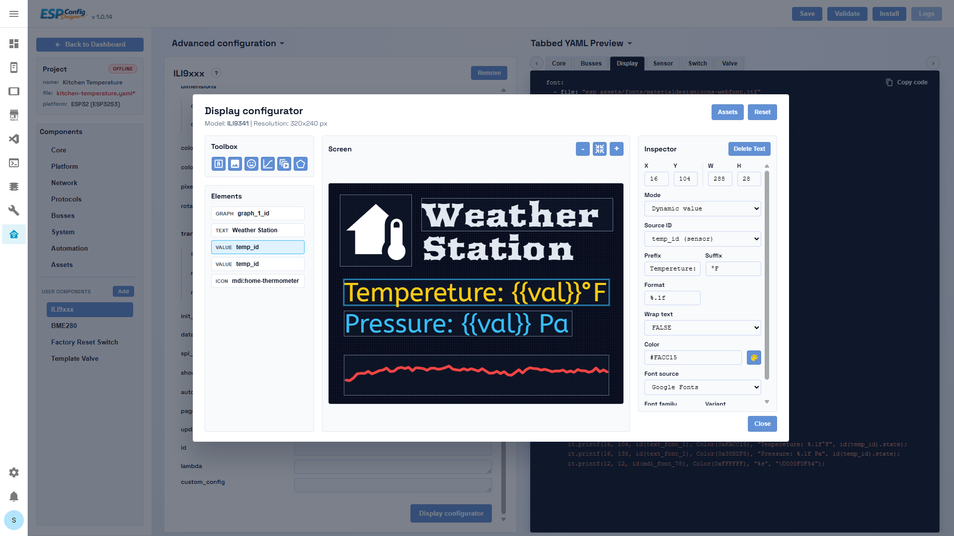

  • Display Configurator for display-based projects

HI I have installed this and it looks great but for some reason when in the display editor i cannot see any entities - have i missed something ??
Paste the full YAML code you generated. It can be just the “User Components.”
For Display Configurator to detect any sensors, you need to assign them IDs. In ESPHome, communication between components always happens through IDs.
