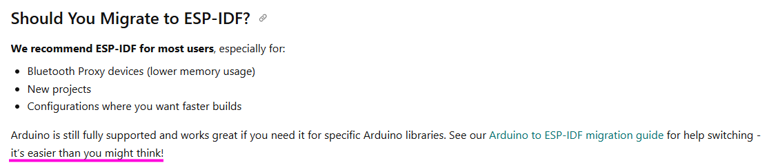

You should consider:
https://esphome.io/changelog/2025.10.0/#should-you-migrate-to-esp-idf
