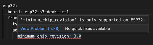

I have a few s3 variants that are complaining about the bootloader, but minimum_chip_revision doesn't seem to like that board type.
Can I just not add that or is there something else needed for the s3 variant?

BTW -- you mention proper indenting on your Wordpress doc, but it's not indented when I look at it.
For the minimum_chip_revision, if there's no warning about that, you shouldn't add it. I kind of mixed two things together since I was seeing both warnings. I'm going to remove all mentioned of that flag - it's not really relevant.

Yeah, that actually kept another board from booting. It would compile and upload, but then would hang and I had to power cycle to get it to revert to the working image. Once I removed minimum_chip_revision everything went fine including updating the bootloader OTA.
