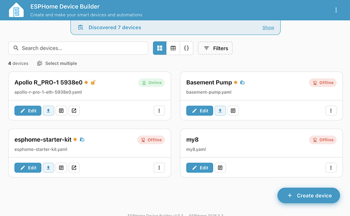

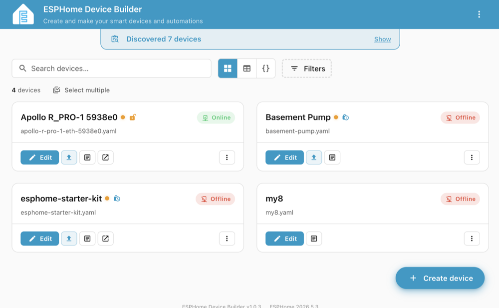

The new ESPHome Device Builder, shipped as an opt-in public beta in 2026.5.0, reached 1.0.0 this release and replaces the legacy in-tree dashboard, which is being retired. The Device Builder lives in two repos, device-builder (Python backend) and device-builder-frontend (web UI), and as of 2026.6.0 it is the dashboard bundled by default in the official Home Assistant ESPHome add-on.
What it brings over the legacy dashboard:
  • Visual component and automation builder alongside a CodeMirror YAML editor, with a left-sidebar device navigator. The legacy dashboard was a plain text editor over a .yaml file.
  • Component catalog with dependency resolution and a per-board pin info viewer that maps GPIO capabilities and shows which component is using each pin.
  • Firmware job queue with progress, history, and cancel for compile / install / clean, replacing the legacy one-operation-at-a-time model.
  • Remote builder: one Device Builder instance can offload OTA builds to another over a peer-paired link (mDNS discovery, out-of-band fingerprint confirmation, identity rotation, per-peer auto-route).
  • Labels, areas, an editable friendly name, device cloning, and multi-select bulk actions (update, delete, archive, and label across an arbitrary set of devices).
  • Out-of-sync detection: an encryption-state mismatch badge on every device, plus version and config-hash in-sync diagnostics in the device drawer.
  • YAML diff view, cross-config YAML search with surrounding context, and a command palette (⌘K / Ctrl-K).
  • Card and table views with configurable columns and faceted filters (platform / status / area / labels).
  • Real settings UI with light / dark / system theme and localization underway across multiple languages.
  • First-run WiFi onboarding and an expanded install-method dialog: Web Serial flashing, server-side USB (relabeled for the Home Assistant host when running as the add-on), web.esphome.io download, and manual .bin download.
