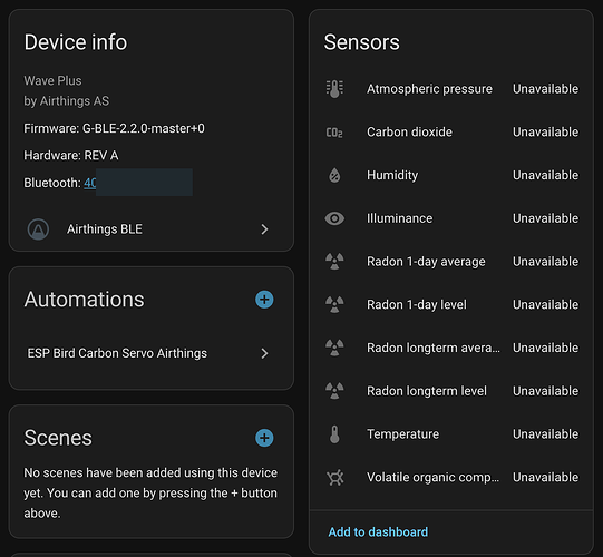

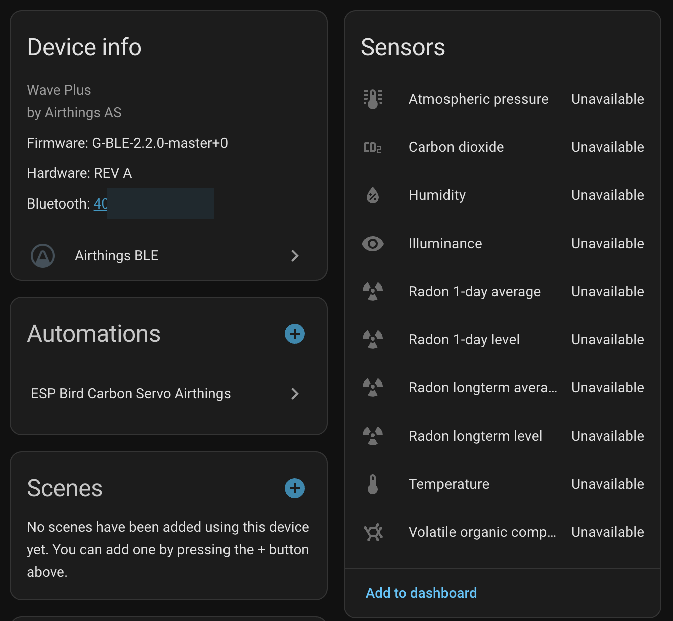

Not a direct answer, but I do use a Airthings Wave+, and the other day, I needed to replace the batteries. The Wave + worked just fine, before I replaced the batteries.
Now I cannot pull data from the device, through ESP BLE Gateway.
It did work stable, before the battery-replacement.
I have checked with my phone, by installing the Airthings app again. My phone does connect without problems. A firmware-update was also waiting, so I also tried that (2.2.0 firmware is the old one, as HA cannot talk with the device right now). I have removed the app from my phone, to secure it does not try and talk with the Airthings Wave +.

I'm not really sure what to do now.
Remove the device in Home Assistant, and try again?
I'm not really sure what to do next, as I've tried what I can think off. Maybe the next step will be submitting a issue; GitHub - Airthings/airthings-ble: Library to control Airthings devices through BLE, primarily meant to be used in Home Assistant. · GitHub
But it must be something minor, I just need to adjust, or similar... However, I've not made any changes, since the battery-swap.
Update:
As I noticed it worked just fine if I usd ESPHome and the airthings_wave_plus platform, I decided to remove the Integration. After ESPHome was done compiling and data was showing up from that, well... Airthings showed up again as a discovered device. I added it, and wolla, things worked again. I don't get why. But, now it works again.
