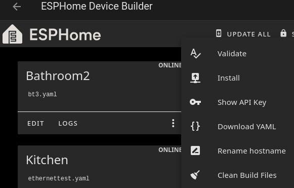

might help. Clean build files.

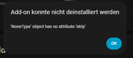

Thank you all for your answers, I tried all things and now I cannot uninstall ESPHome… I think the initial problem lies with ESPHome, when trying to uninstall it just throws an error.
I am currently reading other articles on the forum, to figure out how to uninstall all of ESPHome, before reinstalling.

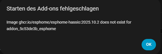

I also cannot start ESPHome properly…
