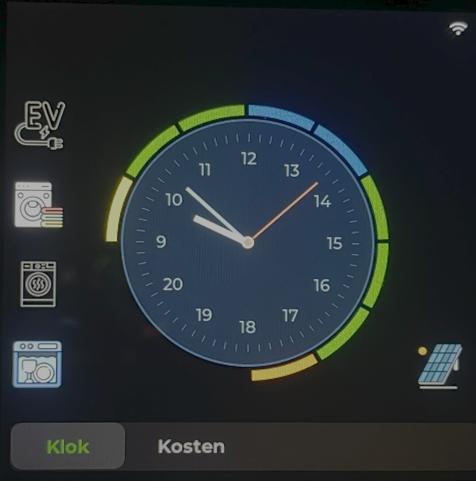

Tariffs as a ring around an analog clock. And usage the same way as in the Zonneplan app.
This 8x8 cm touch display shows an analog clock with for the next hours a tariff color.
Green for low, Yellow, Orange and Red for higer tariffs. And Blue when it is negative.
The status of my most consuming devices are on the left. Ans the status of the solar panels on the right.

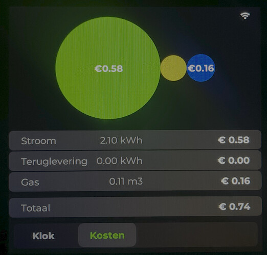

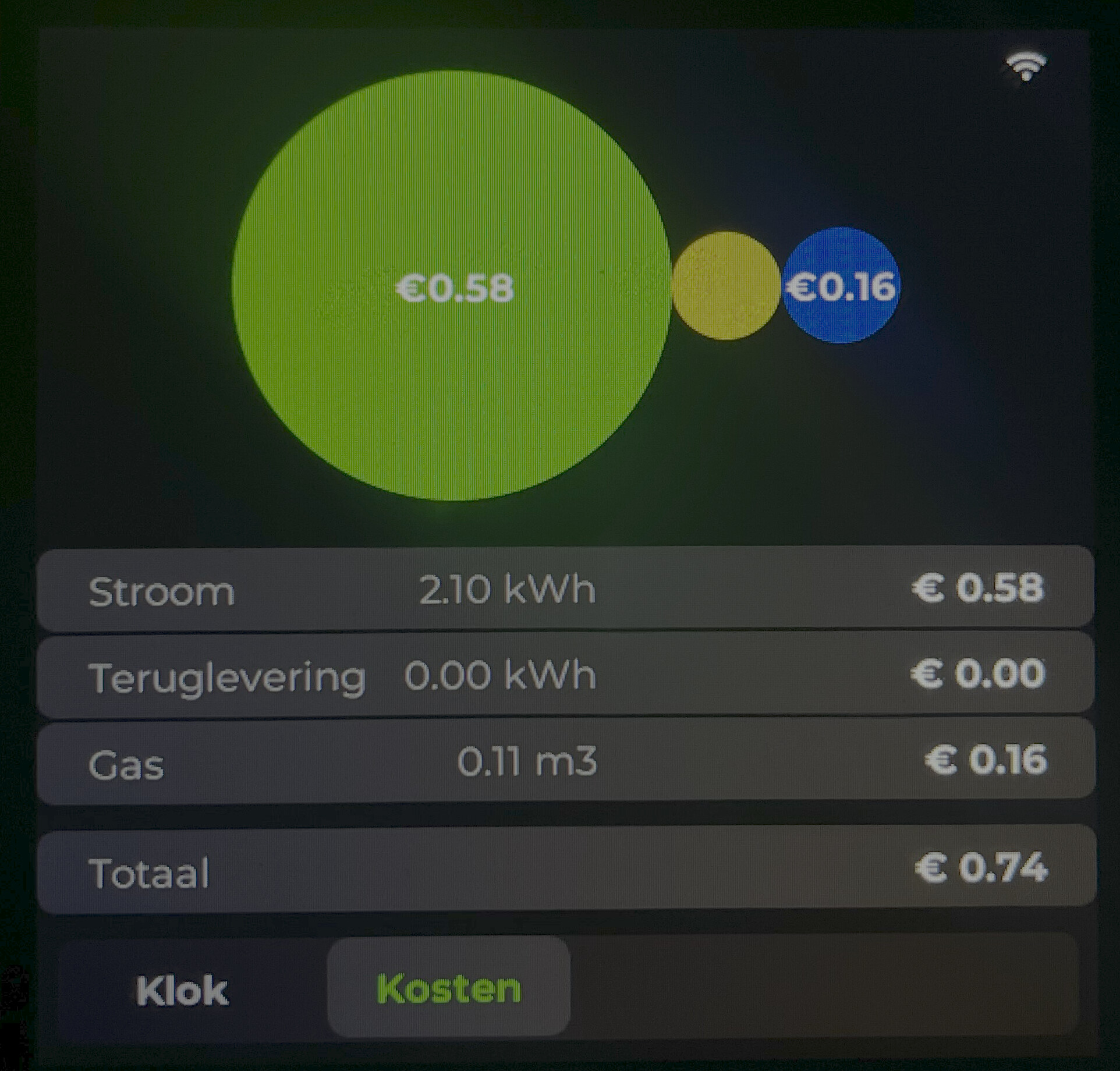

The nest page shows the amount of electricity from and to the grid. And the gas used. The size of the circles show how they compare to each other.
