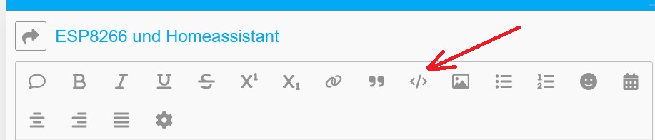

@ Francisclou: If you post code please use
YAML is an indentation-sensitive language. The number of spaces before each command is important. Supporting your code in a corrupted version is very difficult…
