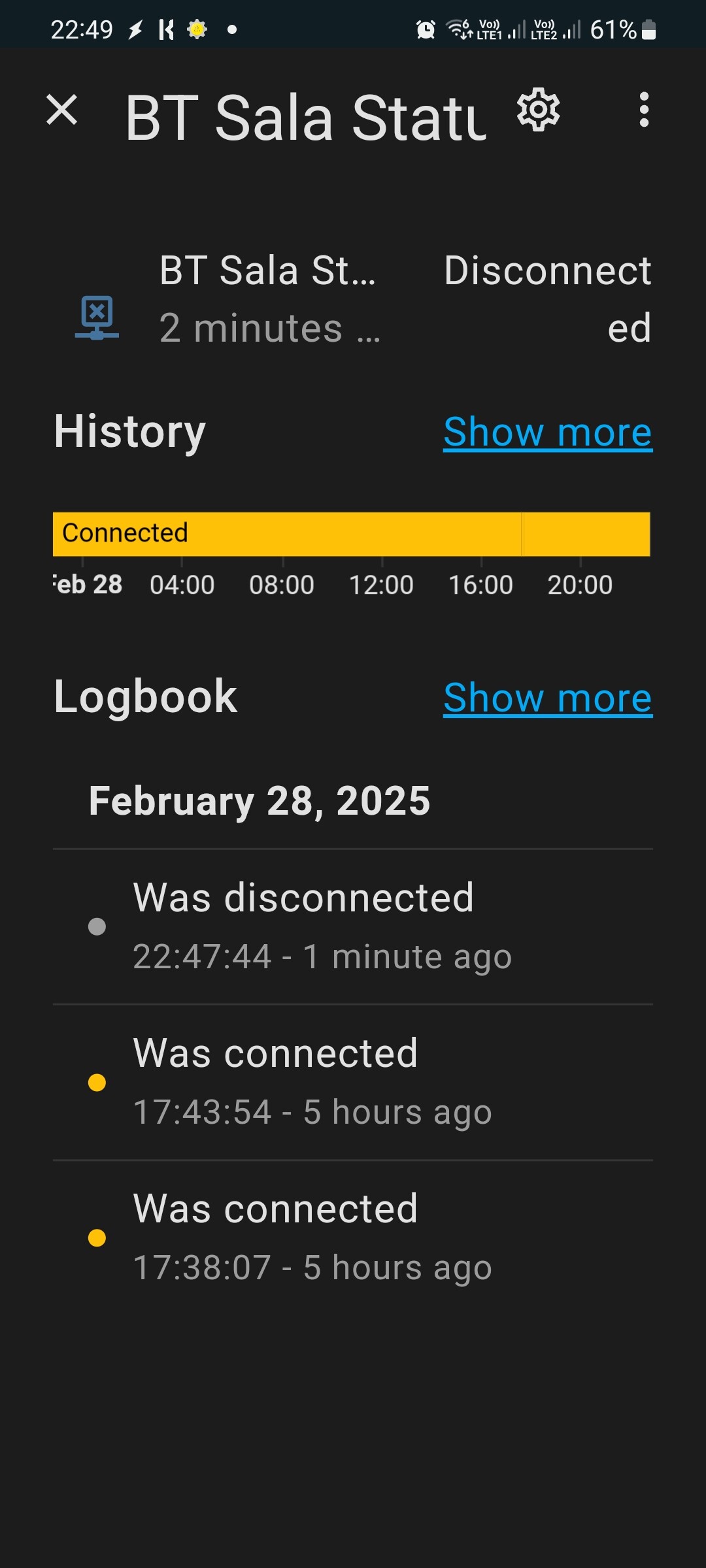

I noticed that the status of ESPhome nodes updated to the latest version always appear online on HA. Additionally, ESP variables in HA dashboards no longer appear as “unavailable”. This happens when I turn off the ESPhome node, or if I turn off the WiFi. However, it doesn’t happen when I soft reset the device. Does this happen to you too?

My offline devices appear as offline so working correctly. I am using ping status and not mdns though.
*Did just switch to mdns and still shows offline correctly.
Hmm maybe that’s the difference. I’ll test later. My devices that were already offline appear offline, have you tested taking an active one offline?
With mdns set turning the device off and it stays online. With ping it cycles correctly.
