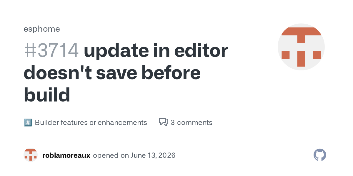

I have seen this discussed elsewhere, and it is a deliberate thing that has changed with the new UI, can't remember why.
It was fixed in 2026.6.3
Where?

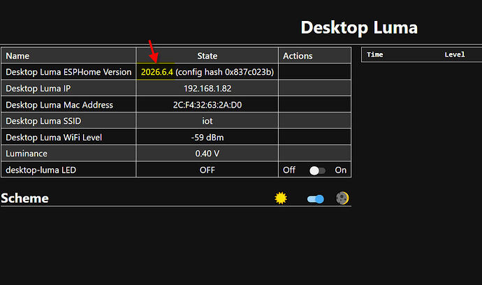

This is my web UI

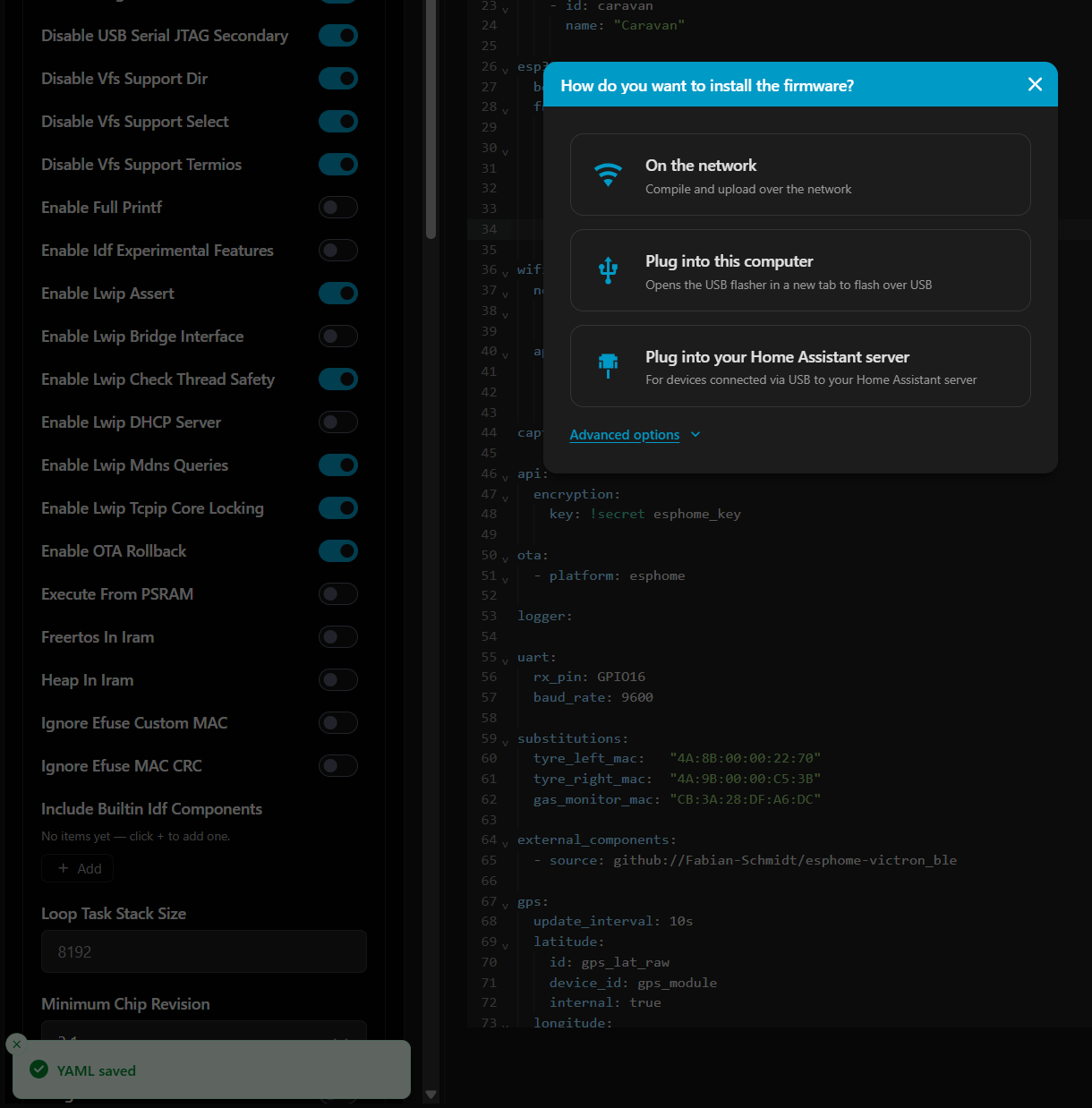

I'm on 2026.6.4 and when I click INSTALL, I get this popup in the bottom left corner if I don't save:
This is what I saw:
True, with a note that if you didn't do that then old (non-corrected) version was compiled and uploaded to device.
Again true, i just checked with 2026.6.4: if i open yaml, change one parameter, hit "install" now installs new version and saves. No info about "saving"or "saved" is given, though, but when i close yaml and re-open it i have changed (new) version saved. If i remember correctly previous version showed "saved" in bottom right corner.... ?
See above, its in the bottom left
Yeaaah! Thanks. I automatically looked right only...
