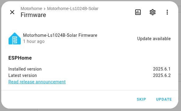

There’s something odd going on here. These two are the same thing:
Yep. I suspected so…
Addition info: The Settings tab reports n Updates.
So following the link:
… and clicking UPDATE (lower right) - it DOES update. And the setting bubble count goes down!
