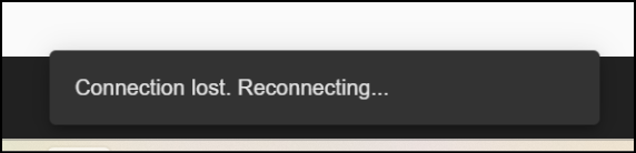

ESPHome Builder: Connection lost. Reconnecting

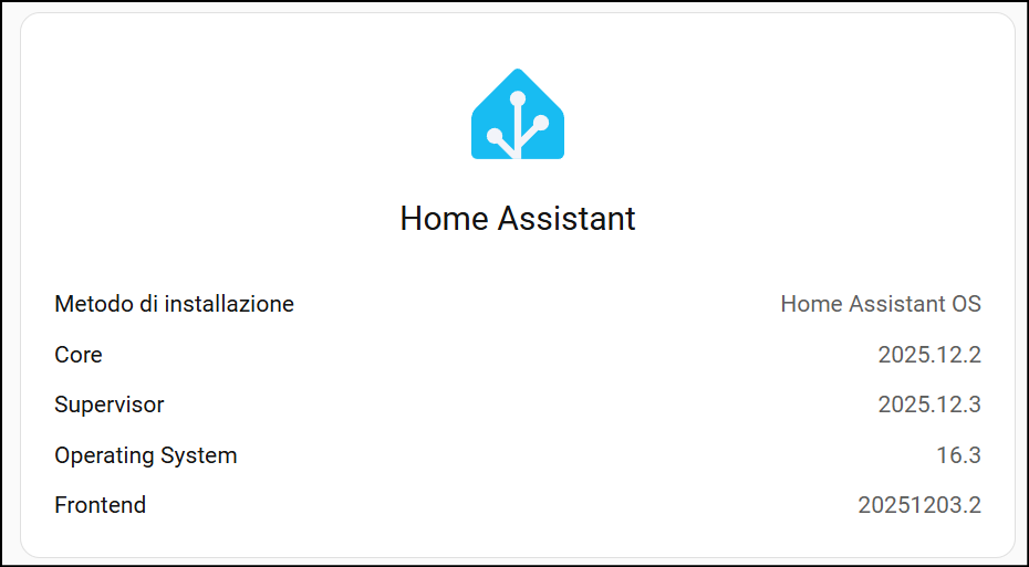

After updating the HA Core, ESPHome Builder no longer works and continues to display the message:

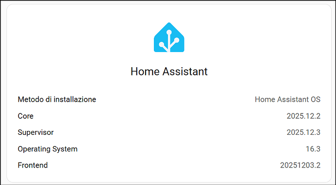

The HA versions are:
Post your yaml code (formatted) and compiler log.

The manifestation is a blank ESPHome Builder dashboard with the rotating “Connection Lost. Reconnecting…” and then “Connection restored.” Over and over.
