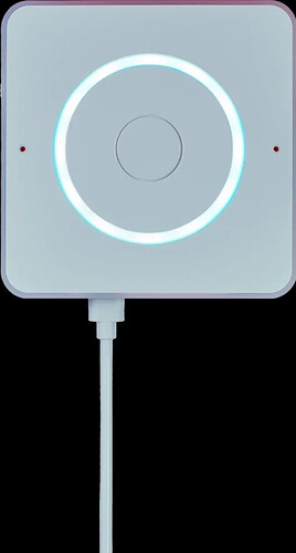

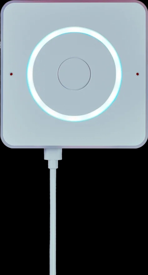

You didn’t include what you are using for your YAML. Presumably you are using something related to this: Home Assistant Voice Preview Edition - Home Assistant
Note the Preview Edition. That means it isn’t a final version and there are likely to be breaking changes until it gets to a real stable release.
Also note the picture, which shows a device with a light ring
The block diagram also clearly shows a WS8212 string, so I expect that it is configured by default.
