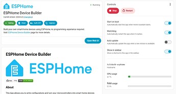

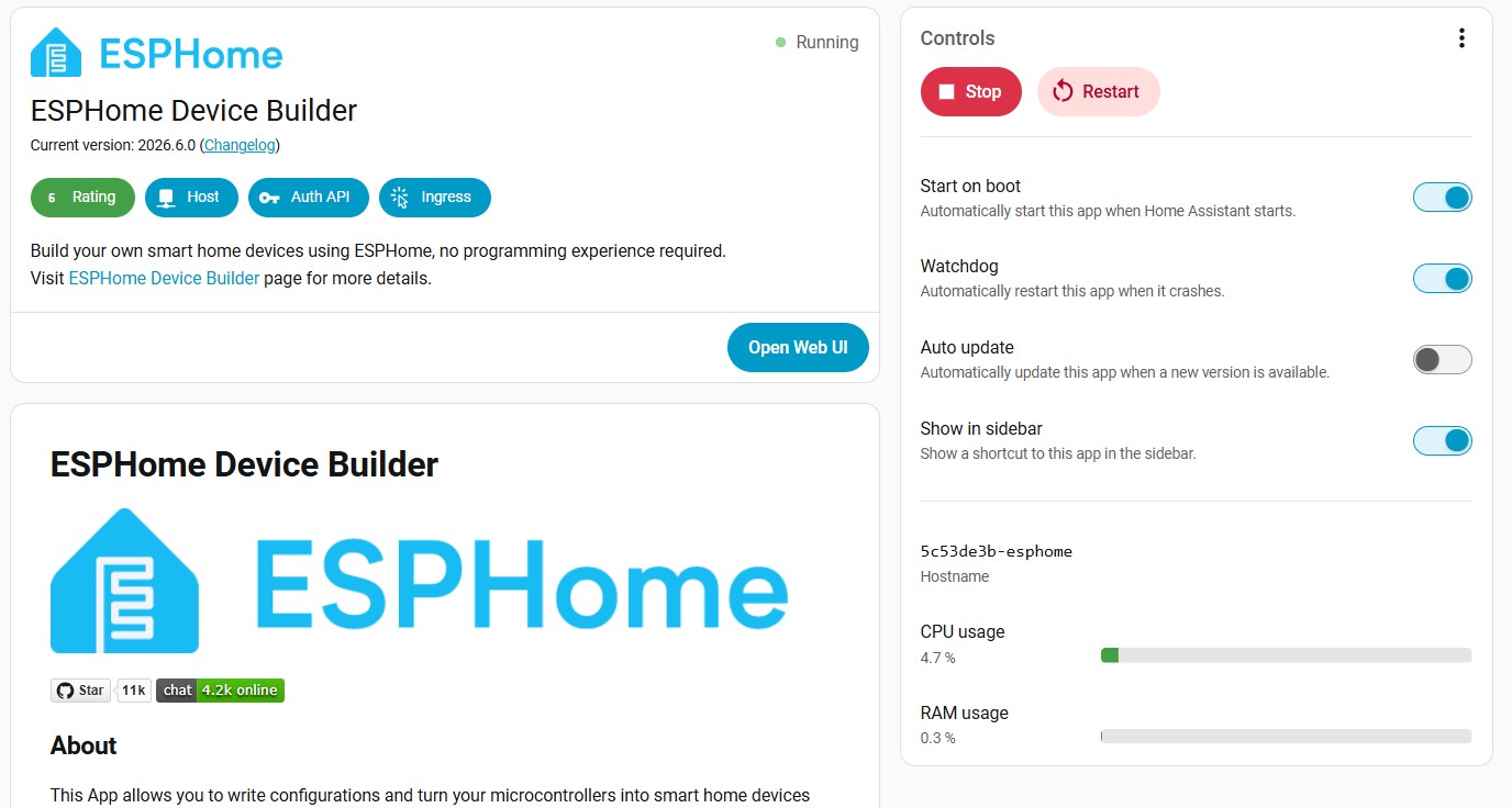

Just Upgraded from 2026.5.3 to 2026.6.0 & it no longer starts.
Shows as Running in the Settings/Apps & have tried resetting defaults & a full reboot.
Running a standard x86 build on an i5 NUC.
All other upgrades current.
Log File Attached.
(Inserted as I don't seem to see file attachment options).

Restored 2026.5.3 from Daily Backup & it's working fine now.
Tried the same on My Test Nuc, which is essentially the same Hardware & Base Software.
Upgraded Ok.
Tried again on the Live Nuc, Restoring Default Configs for EspHome
& again it failed, & restored successfully a 2nd time.
Can Someone who Understands the Log see a reason Why I can't Succeeded?
The log explains itself.
Turn "Disable external authentication" off to use ingress-only mode,

Have also now found I can make 2026.5.3 fail in the same way by turning on the
"Use New Device Builder Preview".
I had external authentication turned on to allow VS Code to Communicate.

Now have it Working with External Auth Turned off,
(Still fails if on, but don't quite understand how it's meant to communicate externally).

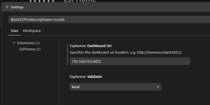

I Generally Edit My Main Device yaml file in EspHome,
While having My Packages & LVGL's Open in in VS Code.
In the ESPHome VSCode Plugin, it is configured like this:-
Anyone Else know how this shoud be set for 2026.6.1 and future releases?
Thanks.
Try setting VSCode to use 192.168.59.5:62351
No idea if it'll work in 2026.6 though.
And make sure that VSCode extension is updated if applicable.
