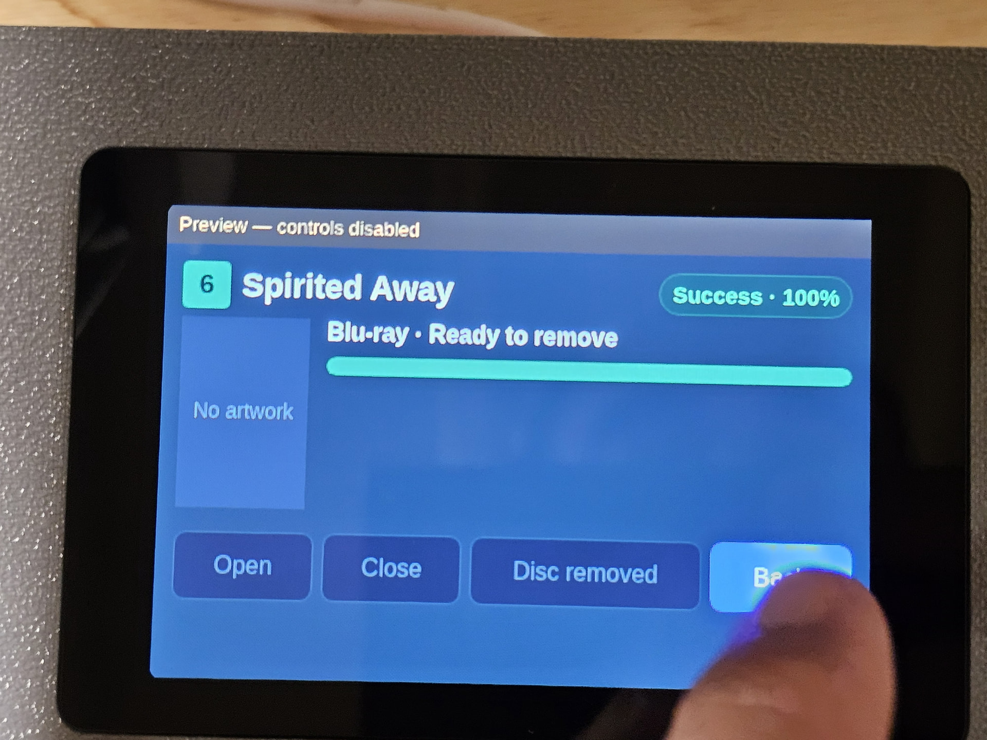

The display I had lying around

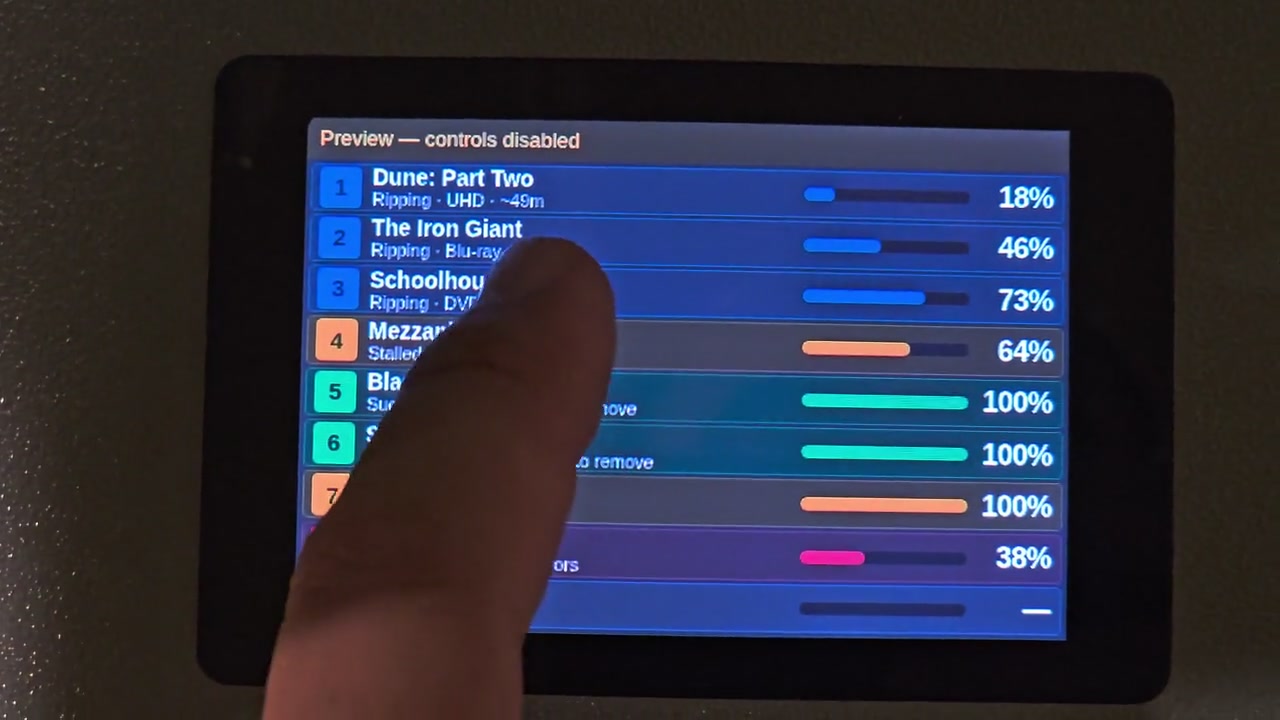

It doesn’t matter which device or display you use, but this one is a 480×320 ESP32-S3 device with capacitive touch. The display quality is awful, but it gets the job done. I configured it to work with my Rip Deck software that lets me monitor and control ripping a bunch of discs at once:

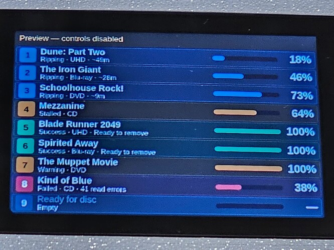

What it looks like up-close
Fake data showing all states on the device itself

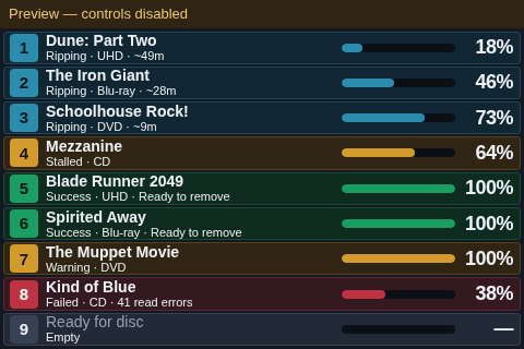

The same web view taken from a browser

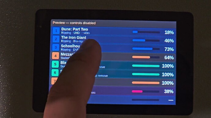

This is showing the kiosk mode I added to it last night that also works with CastKit. This is what I mean about bringing two unrelated projects together.

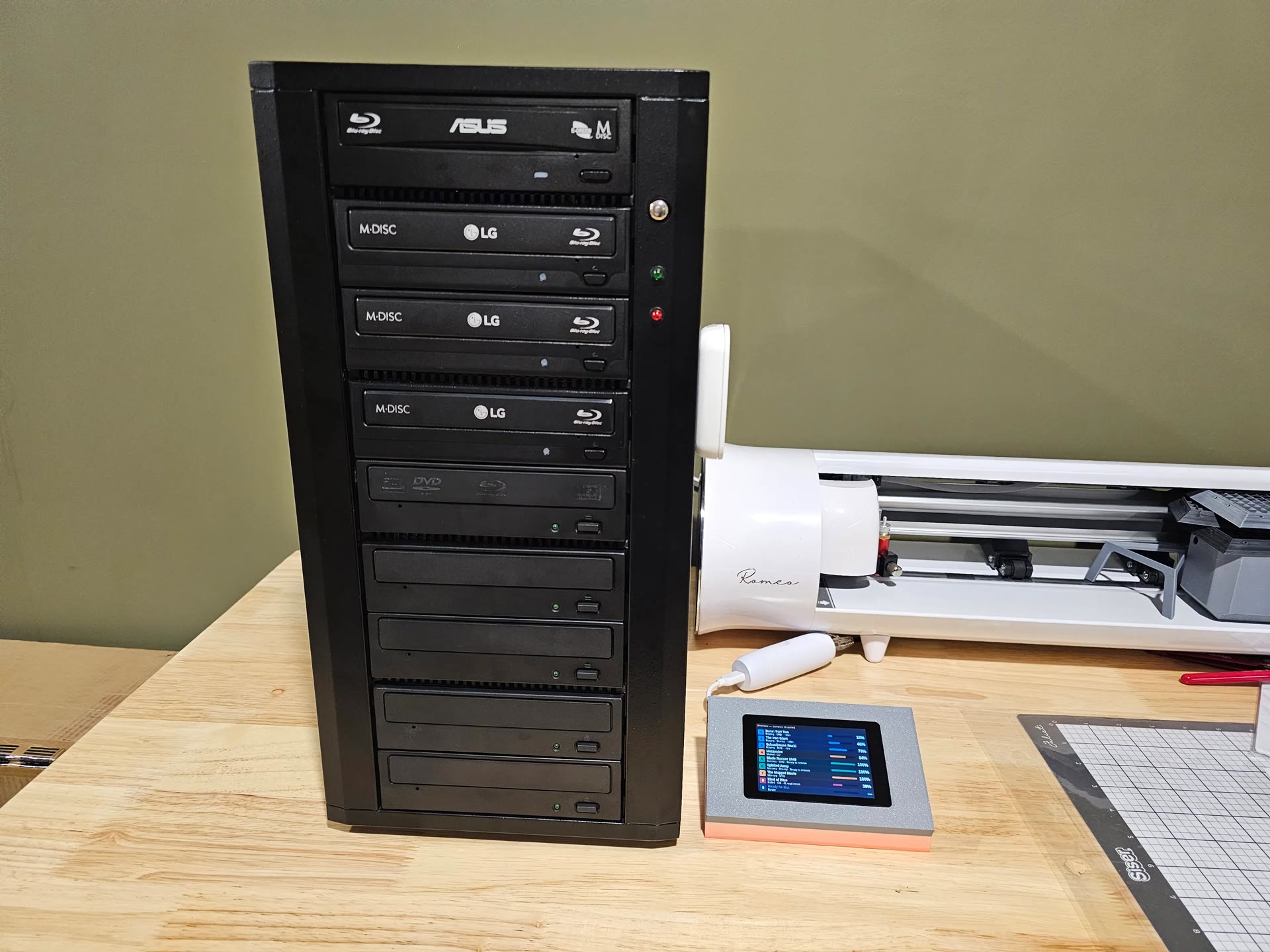

I originally picked up this “WT32-SC01 Plus” (2 MB PSRAM) for a 3D filament weigh and scan project, but it ended up not working out for me, so I had it just lying around. Last night, I decided to use it for my Optical Ripper Tower since it sounded like a much better idea than the tiny LED strips I was working on.
It also took only 2 nights to get it working including test-printing the case with whatever random colors I had on hand (the AI agent chose them).

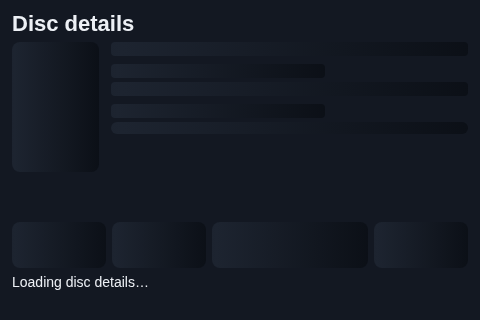

Each application can provide a loading or skeleton page in a small JSON manifest. CastKit renders that page once at startup and preloads the bitmap into the ESP32’s PSRAM.
When the user taps something, the firmware can draw the cached skeleton immediately while Chromium loads the real destination. Now, it feels instantaneous. You don’t even notice the loading screen. It literally takes less than half a second, but it felt super laggy without this feature.
