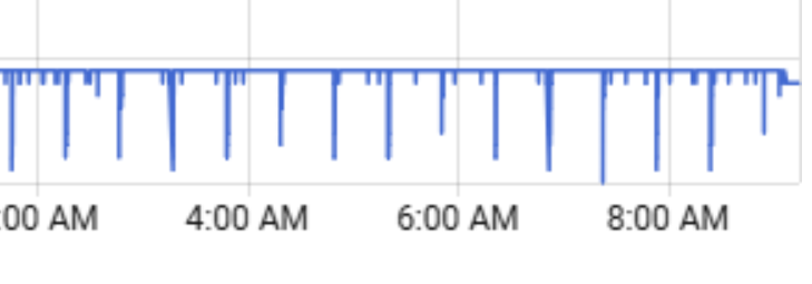

I’ve got code in HA now counting how many of the LEDs have toggled - I have to wait a second after I send all the Pushbuttons , I’ve got two out of sync in an hour (Every 5 seconds , 9 devices) not very often but it happens - If I count straight after the send pushbutton script - some of the states have not reported back , so I need to wait

This screen shot shows how often it fails it should be 9 or zero - so all the short points are where it is failed
The 9 devices are very close together in a room with a metal roof and the Access point
There would be a lot of reflections, it fails a lot more when I sit down in from of the devices
The code is making it worse as it is guaranteed all 9 commands are sent one after the other
It may be that out in the garden with unsynchronized commands this happens much less often
