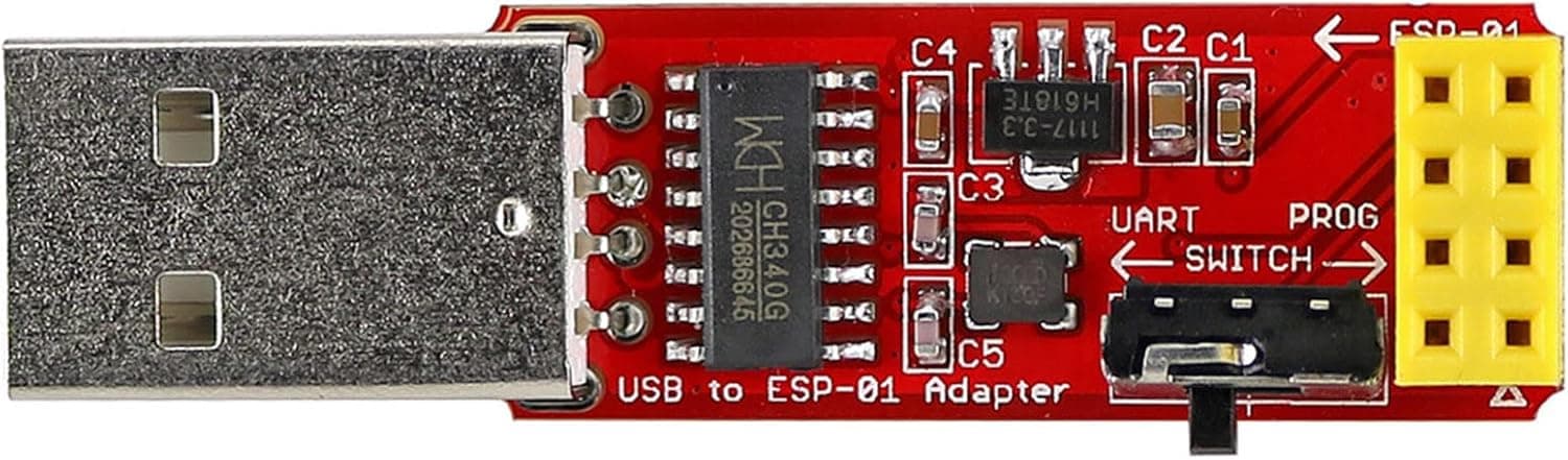

Thank you, @Chreece, for your work, I tried to install your component on a Midea Cube 50 without success, from which I removed the EU-SK105 key.
I used this DIYmall USB to ESP8266 Breakout CH340C for programming.
And this DIYmall USB to ESP8266 Breakout CH340C
on connected to the MIDEA CUBE with the switch on UART position.
I am assuming that in the UART position, the USB connector pins are serial TX, RX, VCC and GND.
The problem I am encountering is a total lack of data in reception.
Analyzing your code, I noticed that the reception buffer remains empty.

Now I don’t know if your usb adapter has level shifters (probably not) which are necessary because the signals from the device are on 5V and esp can read only 3.3V.
Edit: you could also try turning the switch to programming

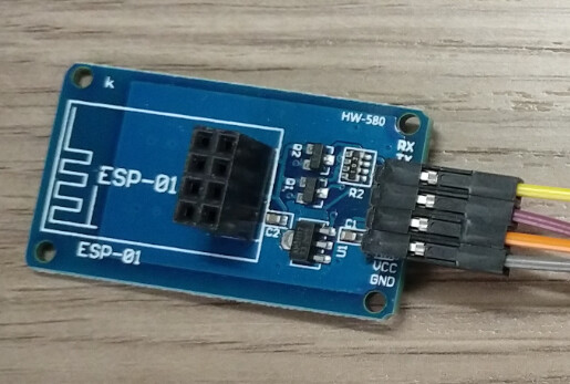

Hi Chreece, the adapter has a level shifter, the VCC pin is at 3.3V.
It would appear that the adapter converts the TX and RX (RS232) signals to D+ and D- (USB) even in the UART position, always passing through the CH340C chip.
I’ll try with an ESP-01 adapter like this, the one suggested in Hypfer’s esp8266-midea-dehumidifier :crossed_fingers:
UPDATE
Now with above adapter the firmware works with my Midea Cube 50.

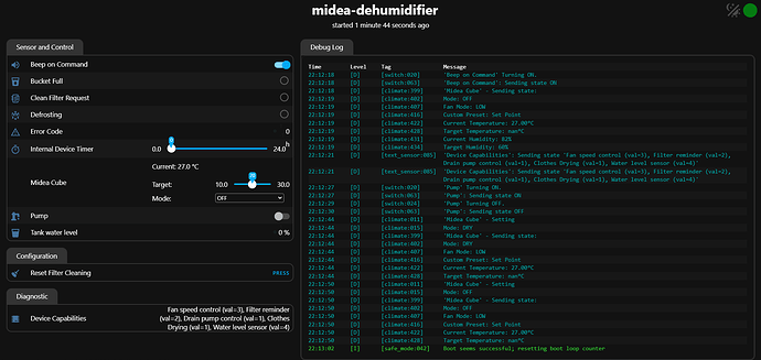

I added the WEB component because I want to control the dehumidifier from a Shelly device via the REST API.
The following endpoints work:
http://midea-dehumidifier.local/climate/midea_cube/set?mode=OFF
http://midea-dehumidifier.local/climate/midea_cube/set?mode=DRY
http://midea-dehumidifier.local/climate/midea_cube/set?fan_mode=LOW
http://midea-dehumidifier.local/climate/midea_cube/set?fan_mode=MEDIUM
http://midea-dehumidifier.local/climate/midea_cube/set?fan_mode=HIGH
but /set?target_humidity or any /set?custom_preset endpoints do not work.
@ChreeceGR please, do yo have any suggestion?
This is the webserver page, as you can see this options are not present:
Sorry I can’t help you with that. I’m not using rest API and in docs there is no mention of climate.

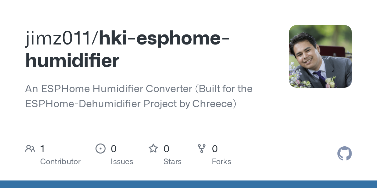

No problem, I had seen the PR’s so hopefully it will get added. For now I will just create a custom integration for it. Shouldnt be too hard. If I manage to make that and if there is interest in it I will share it once completed.
But thanks a lot for this, works like a charm!
Edit: I have finished the custom component, anyone that wants this can download it here:
Great thank you for sharing it.
I still like the climate entity because there are all controls you need on it (fan speed, on/off, swing) and no need to create separate entities.
The home assistant humidifier domain is a bit outdated in my view
