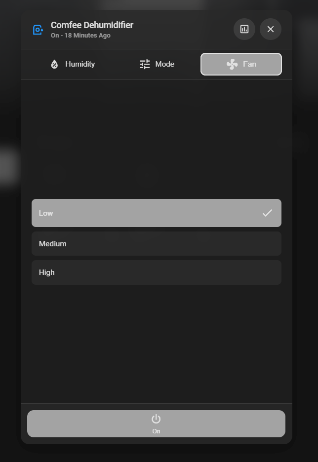

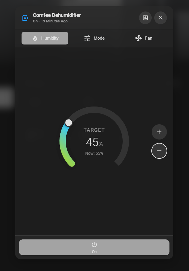

I agree with you on that. But since I use my own popups and cards I simply added this stuff into my cards, so not a problem for me otherwise.
I just created this component for myself, but I figured that if one would like to try it (or really want a humidifier entity instead of climate) then they could simply download my component and do so.
But yeah the humidifier component is indeed a bit weird and I wish it would be more like climate (with fan speed control etc).
Regardless, you have done me a great service by creating this ESPHome component. Once again thanks!

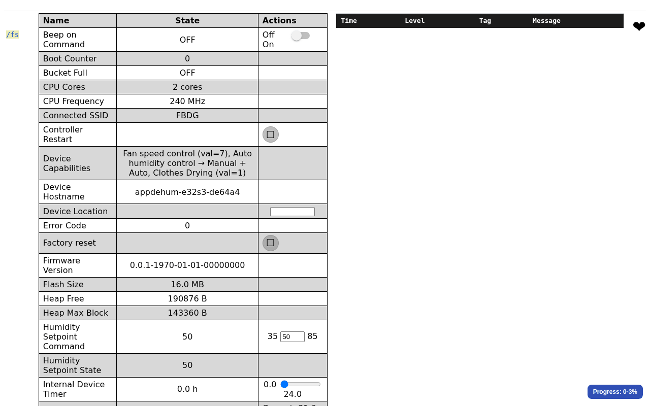

I ended up taking the leap to ESPHome and ported my Tasmota application with the help of AI.
As long as all required REST services are available on the controller, the UI can be adjusted without recompiling.
All web files of the project are merged into SP.HTML.
I think the result is quite decent.

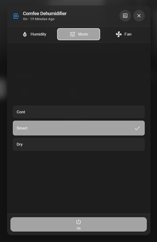

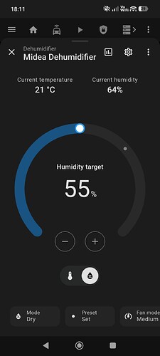

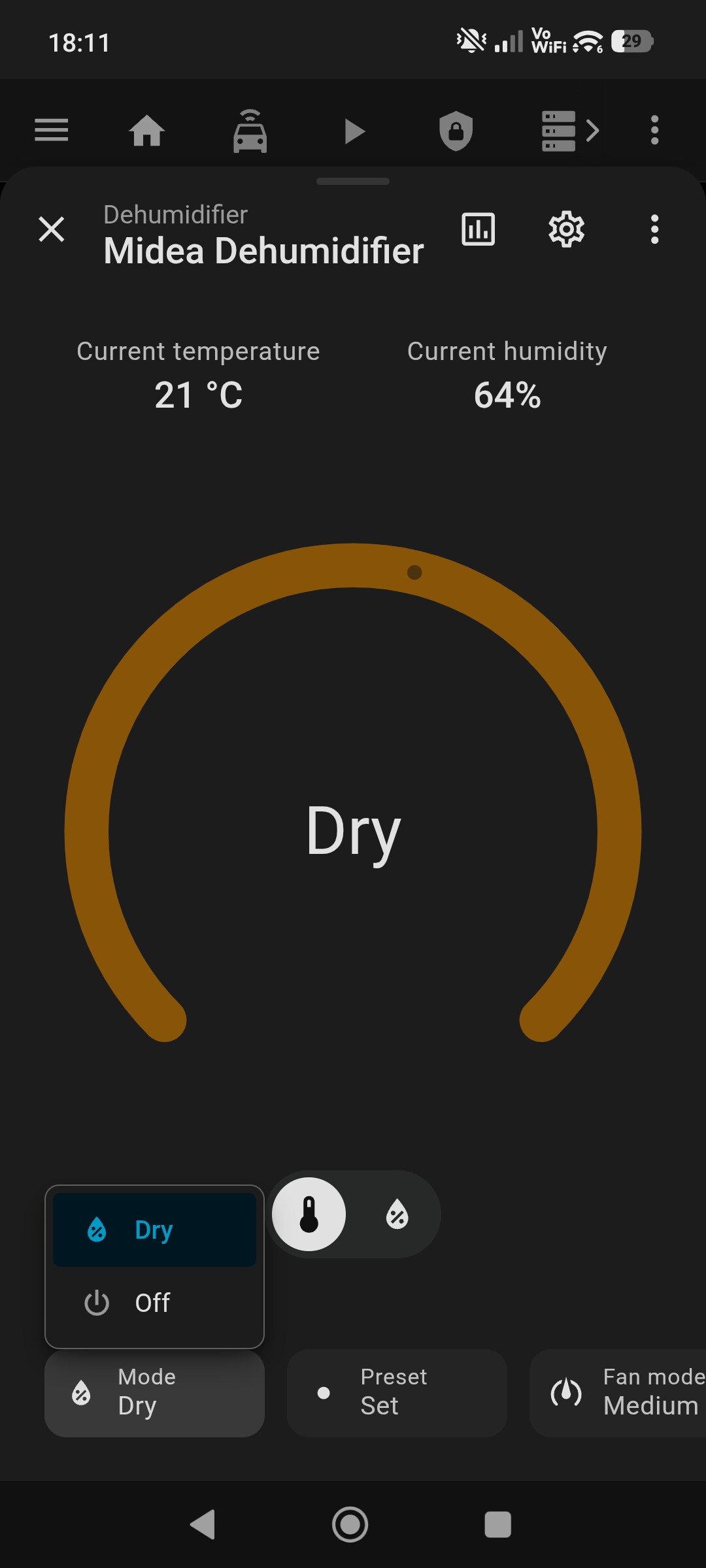

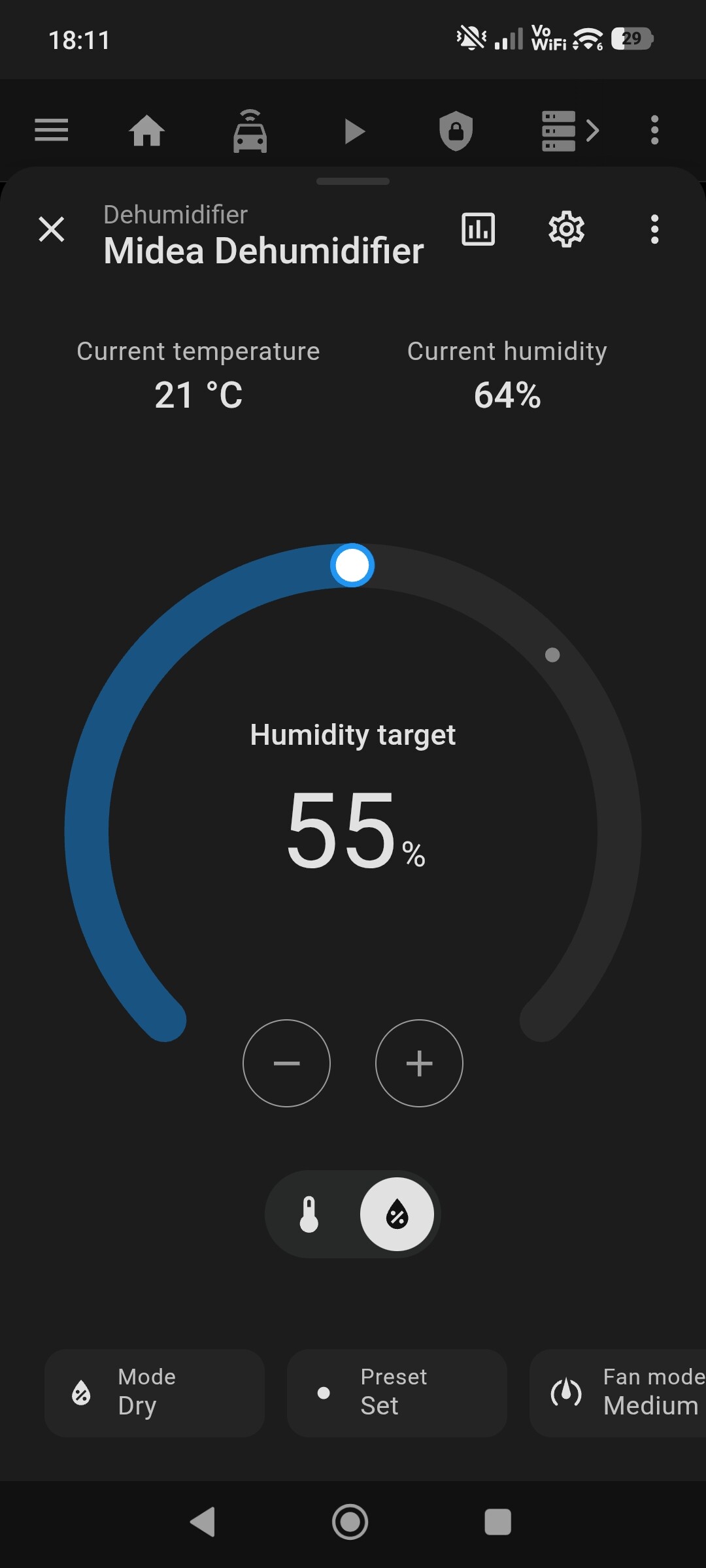

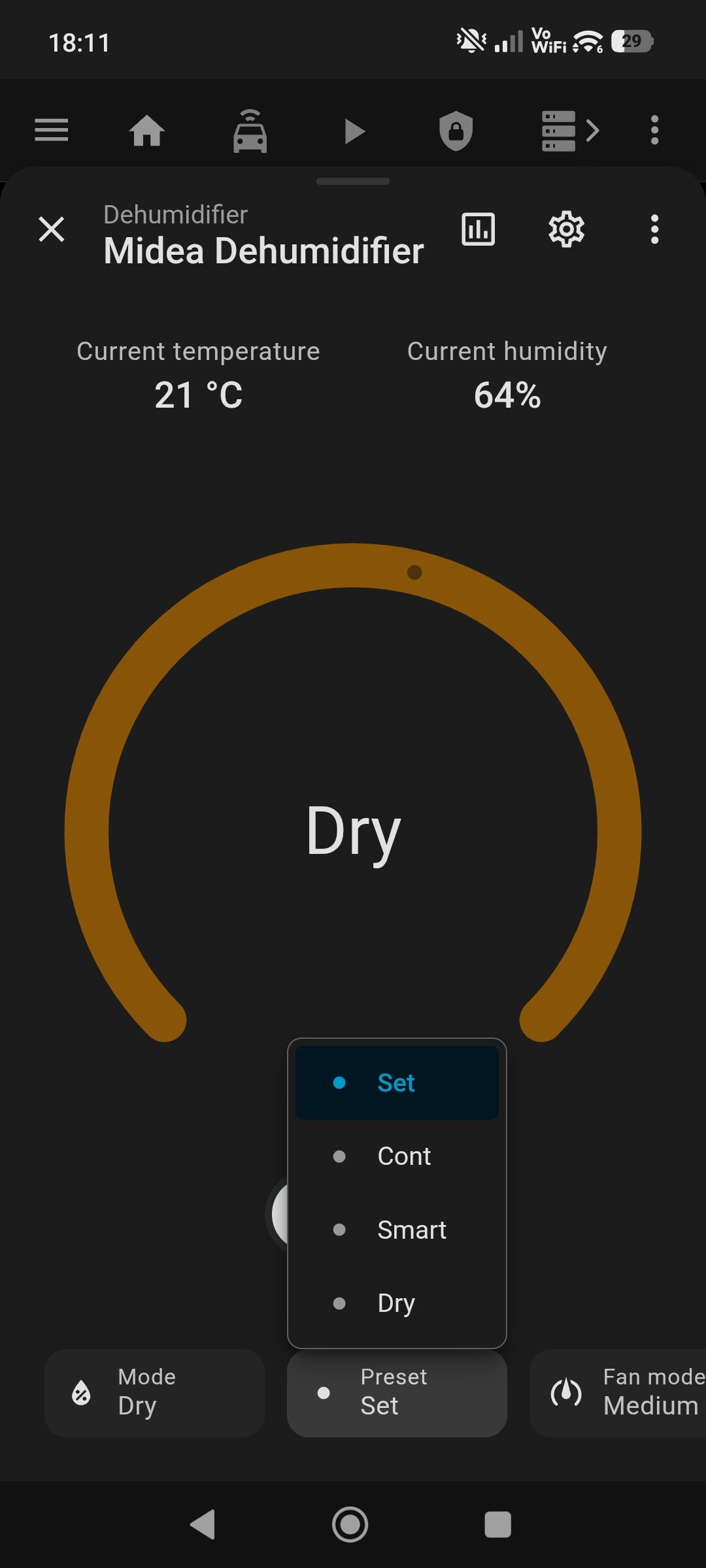

Only thing i find a bit strange is the chrome to turn it on.
You first have to set it to Dry mode and then there's 2 options: Dry and Humidity Target.
What's the difference here?
I think the Mode should be On and Off.
I have the 20den7-wf as well.
The difference is described in the manual of your dehumidifier. Maybe someone with the same model can help you.
I mean, there's a Dry mode as well on the device. But in HA to turn it on, I have to enable Dry mode and then i can actually switch between the 4 modes on the device.
See screenshots:

*sorry for the late answer I’m not very active here. The climate entity in home assistant doesn’t provide an ON state. The one used for dehumidifiers is the DRY and it’s equivalent to ON. The DRY mode (not state) and all the modes can be selected only when the device is on and that was a hardware limitation if I can remember correctly
