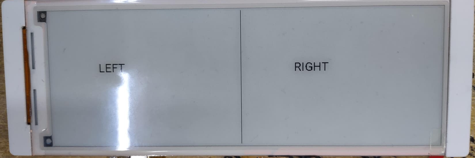

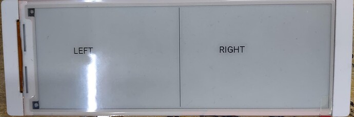

The display: Elecrow DIS08792E — 792×272px black and white e-paper, runs on an ESP32-S3. What makes it unusual is it uses two SSD1683 driver chips in a

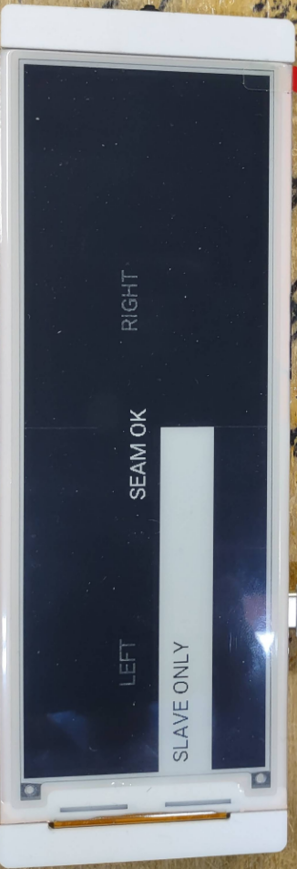

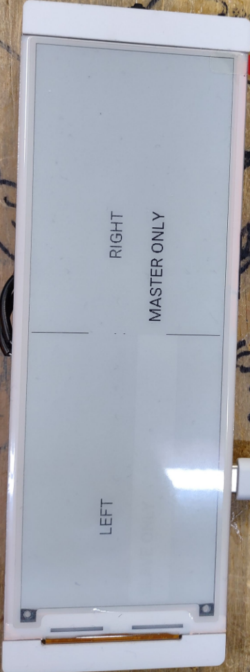

master/slave cascade to cover the full width. There’s no existing ESPHome component for it and the dual-chip setup took some work to get right.
What the driver does:
  • Full display buffer across both chips with correct seam alignment
  • LVGL support working (color depth 16, on_draw_end integration)
  • Partial refresh — update a specific region of the screen without a full refresh cycle, confirmed working across the chip boundary
  • Deep sleep friendly, presence sensor wakeup, standard SPI config
