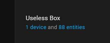

  • Sorting in the ESPHome Device page (Controls, Sensors, Configuration, Diagnostic). As shown below, with devices that have up to 88 entities, it would be nice to be able to sort them other than just by name. Anyone using LD2410 likely has the issue :slight_smile:
