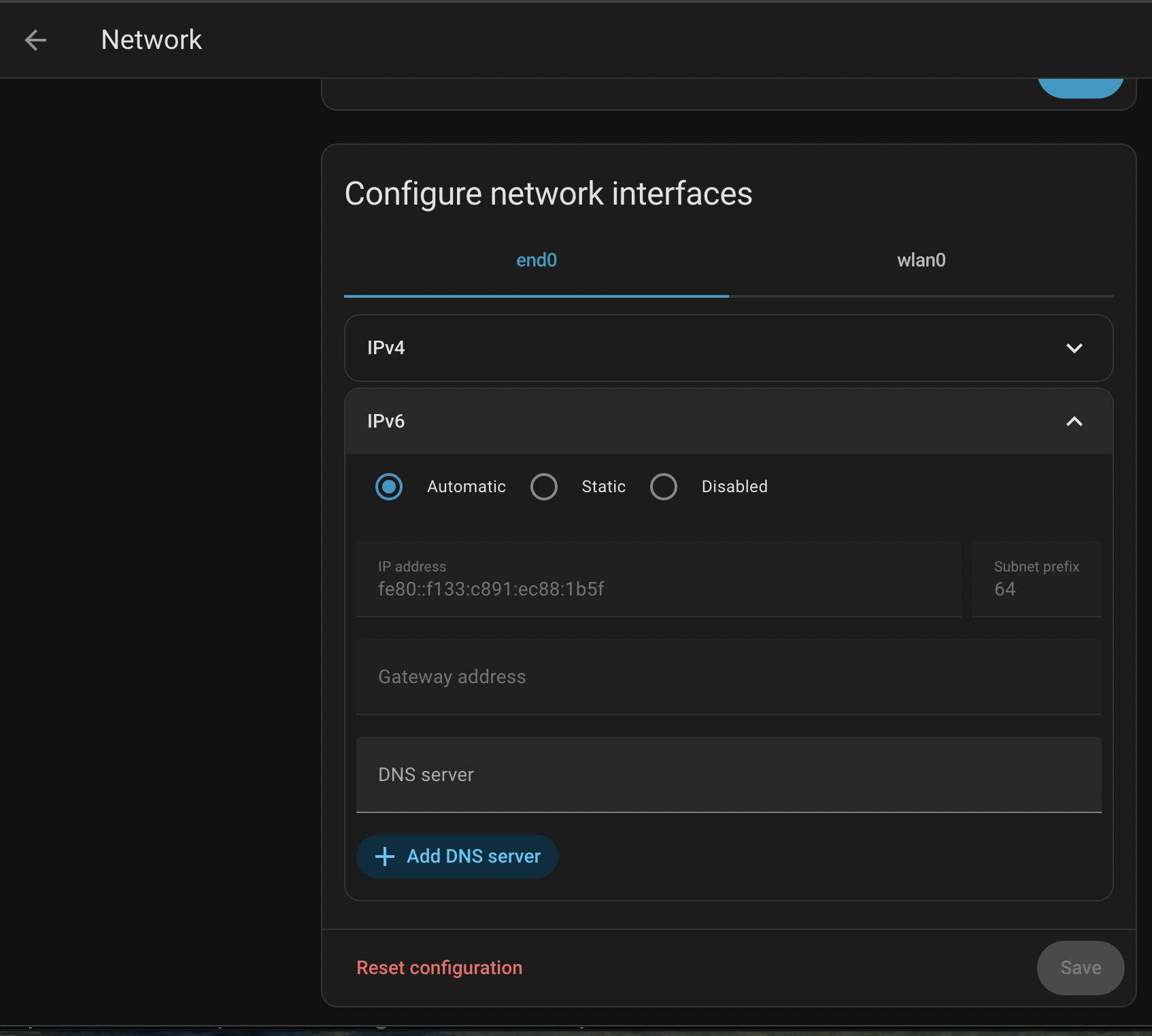

my HA is installed AS HAOS on Rosberry PI 5
about UI->Settings->System->Network->IPv6 settings - it setted up as “automatic”. attached screenshot

HA is not seeing the Route Advertisements from the OTBR. HA should have an additional IPv6 prefix, something like fdaf:blah-blah
how to add additional IPv6 prefix in HA?
