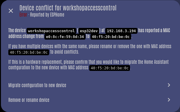

I had a (self-induced) hardware failure on an ESP device. I took an identical device, put the same firmware on it I was previously running, HA saw it - but is now warning me about a device conflict.
Seems it doesn't like the MAC address change. In doing some digging, this was a known problem (honestly, it did not occur to me to have to delete the old one before replacing - I guess I am not used to working with low-level stuff. For identical hardware swap, I am used to just writing the configuration and firmware to the replacement, plugging it in, and turning it on - like the last time I replaced a network switch or router).

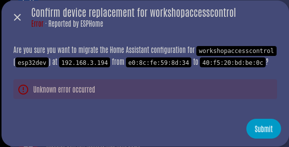

So there is a 'Migrate configuration to new device'. Great. Except it doesn't work.

From the log:
Logger: aiohttp.server
Source: /usr/local/lib/python3.14/site-packages/aiohttp/web_protocol.py:488
First occurred: 23:16:02 (9 occurrences)
Last logged: 23:35:48
Error handling request from 192.168.2.101
  File "/usr/local/lib/python3.14/site-packages/aiohttp/web_protocol.py", line 517, in _handle_request
    resp = await request_handler(request)
  File "/usr/local/lib/python3.14/site-packages/aiohttp/web_app.py", line 569, in _handle
    return await handler(request)
  File "/usr/local/lib/python3.14/site-packages/aiohttp/web_middlewares.py", line 117, in impl
  File "/usr/src/homeassistant/homeassistant/components/http/security_filter.py", line 92, in security_filter_middleware
  File "/usr/src/homeassistant/homeassistant/components/http/forwarded.py", line 87, in forwarded_middleware
  File "/usr/src/homeassistant/homeassistant/components/http/request_context.py", line 26, in request_context_middleware
  File "/usr/src/homeassistant/homeassistant/components/http/ban.py", line 90, in ban_middleware
  File "/usr/src/homeassistant/homeassistant/components/http/auth.py", line 263, in auth_middleware
  File "/usr/src/homeassistant/homeassistant/components/http/headers.py", line 41, in headers_middleware
    response = await handler(request)
  File "/usr/src/homeassistant/homeassistant/helpers/http.py", line 89, in handle
    result = await handler(request, **request.match_info)
  File "/usr/src/homeassistant/homeassistant/components/http/decorators.py", line 83, in with_admin
    return await func(self, request, *args, **kwargs)
  File "/usr/src/homeassistant/homeassistant/components/repairs/websocket_api.py", line 159, in post
    return await super().post(request, flow_id)
  File "/usr/src/homeassistant/homeassistant/components/http/data_validator.py", line 74, in wrapper
    return await method(view, request, data, *args, **kwargs)
  File "/usr/src/homeassistant/homeassistant/helpers/data_entry_flow.py", line 121, in post
    result = await self._flow_mgr.async_configure(flow_id, data)
  File "/usr/src/homeassistant/homeassistant/data_entry_flow.py", line 336, in async_configure
    result = await self._async_configure(flow_id, user_input)
  File "/usr/src/homeassistant/homeassistant/data_entry_flow.py", line 383, in _async_configure
    result = await self._async_handle_step(
        flow, cur_step["step_id"], user_input
  File "/usr/src/homeassistant/homeassistant/data_entry_flow.py", line 483, in _async_handle_step
    result: _FlowResultT = await getattr(flow, method)(user_input)
  File "/usr/src/homeassistant/homeassistant/components/esphome/repairs.py", line 65, in async_step_migrate
    await async_replace_device(self.hass, entry_id, self.stored_mac, self.mac)
  File "/usr/src/homeassistant/homeassistant/components/esphome/manager.py", line 1391, in async_replace_device
    dev_reg.async_update_device(
        device.id,
        new_connections={(dr.CONNECTION_NETWORK_MAC, new_mac)},
  File "/usr/src/homeassistant/homeassistant/helpers/device_registry.py", line 1366, in async_update_device
    return self._async_update_device(
        device_id,
    ...<23 lines>...
        via_device_id=via_device_id,
  File "/usr/src/homeassistant/homeassistant/helpers/device_registry.py", line 1243, in _async_update_device
    added_connections = new_values["connections"] = self._validate_connections(
        device_id, new_connections, False
  File "/usr/src/homeassistant/homeassistant/helpers/device_registry.py", line 1413, in _validate_connections
    raise DeviceConnectionCollisionError(
        normalized_connections, existing_device
homeassistant.helpers.device_registry.DeviceConnectionCollisionError: Connections {('mac', '40:f5:20:bd:be:0c')} already registered with DeviceEntry(area_id=None, config_entries={'01KCCX254F6X94T8J9CBBNEFPS'}, config_entries_subentries={'01KCCX254F6X94T8J9CBBNEFPS': {None}}, configuration_url=None, connections={('mac', '40:f5:20:bd:be:0c')}, created_at=datetime.datetime(2026, 5, 24, 3, 10, 25, 847486, tzinfo=datetime.timezone.utc), disabled_by=None, entry_type=None, hw_version=None, id='622fc4e4af4935c9e10c9034e9d1954e', identifiers=set(), labels=set(), manufacturer='Espressif Inc.', model=None, model_id=None, modified_at=datetime.datetime(2026, 5, 24, 3, 10, 25, 847570, tzinfo=datetime.timezone.utc), name_by_user=None, name='', primary_config_entry=None, serial_number=None, _suggested_area=None, sw_version=None, via_device_id=None, _cache={'json_repr': b'{"area_id":null,"configuration_url":null,"config_entries":["01KCCX254F6X94T8J9CBBNEFPS"],"config_entries_subentries":{"01KCCX254F6X94T8J9CBBNEFPS":[null]},"connections":[["mac","40:f5:20:bd:be:0c"]],"created_at":1779592225.847486,"disabled_by":null,"entry_type":null,"hw_version":null,"id":"622fc4e4af4935c9e10c9034e9d1954e","identifiers":[],"labels":[],"manufacturer":"Espressif Inc.","model":null,"model_id":null,"modified_at":1779592225.84757,"name_by_user":null,"name":"","primary_config_entry":null,"serial_number":null,"sw_version":null,"via_device_id":null}', 'as_storage_fragment': <orjson.Fragment object at 0x7f168aad6630>})
So, it looks like there is an issue with the AIO handler.
