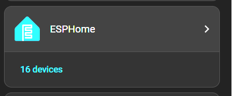

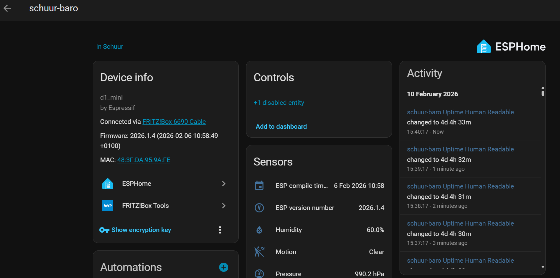

Can you post a screenshot of the device info tab from the ESPHome integration page, to be sure it’s added correctly as an integration. You should see something like this
