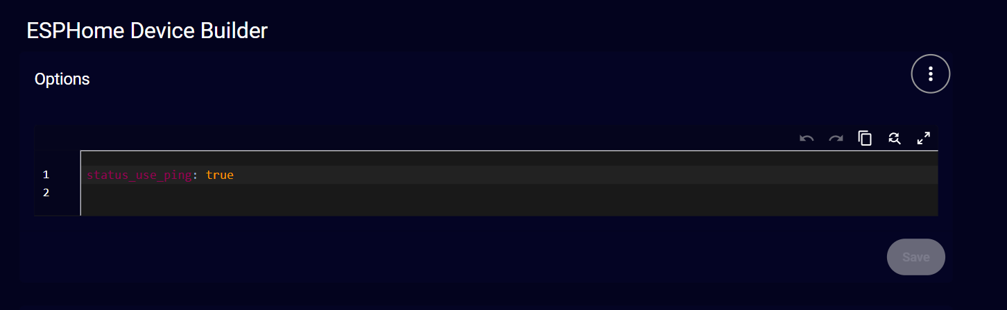

From the addon section you can change the configuration to use ping instead of mDNS.
Online/Offline in ESPHome builder depends on an mDNS response. For example if your device hostname is desklight, then builder pings desklight.local to decide if it’s online or not. There is a way to ping an IP address, but I have never needed it.
Anything that interferes with mDNS will show a device offline.

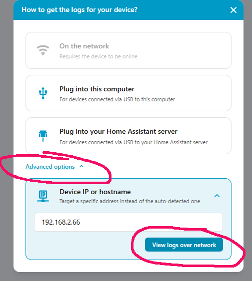

ok now it’s weird, I only see devices online for a while when I’ve just installed a fresh ephome
but now I understand how to still view the log
