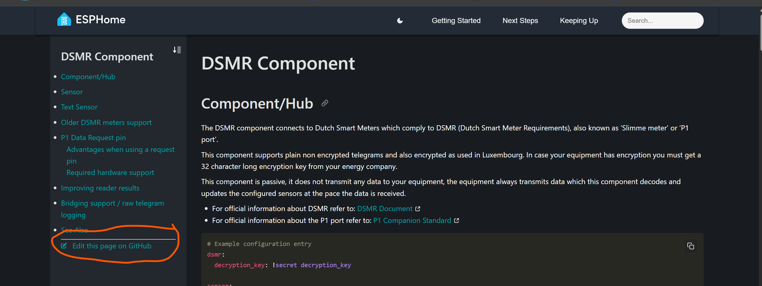

Thanks, how can I suggest they add this to the documentation?

It’s open source, so you can create a PR with your suggested changes
