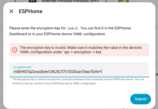

The devices now show up in Home Assistant to be added. I paste the api key into the encryption key field, and I get the following error.
I’m sort of at a loss. Anybody know what is going on?
Try a new api key from this page it generates a new key every time the page is loaded. It’s about half way down the page.
Yeah, that’s where I generated my key from to begin with. I’m going to try again, but of course that means taking apart the device and reattaching the leads.
You might try OTA with esphome (it uses the other key that might work). If you do take it apart again, you might try a blank OTA key (no key). This means anybody on your network can overwrite the firmware, so not secure, but might be okay to debug the issues.
