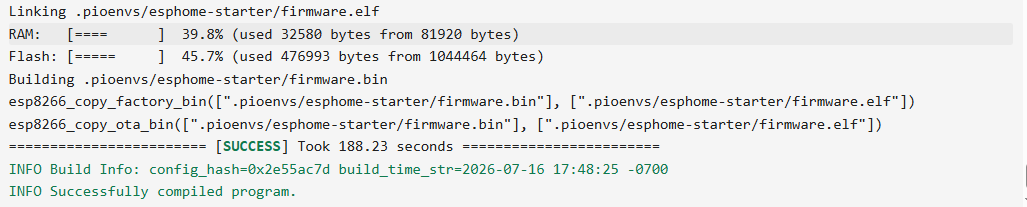

I click on [^ Install] and choose Plug into this computer. Eventually, I get the message
No flashable binary available for this device. web.esphome.io supports ESP32 and ESP8266 only.
