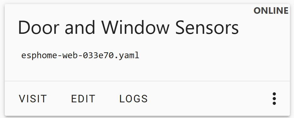

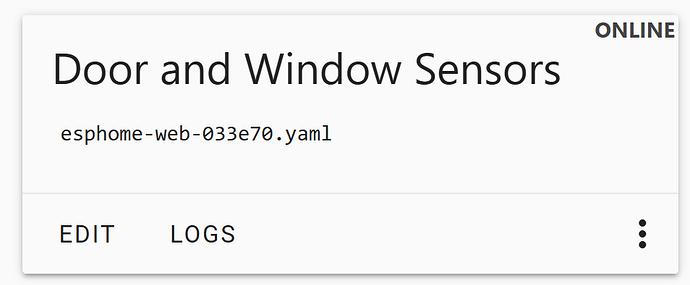

But once i switched to the ethernet module the visit button from the GUI disappears.

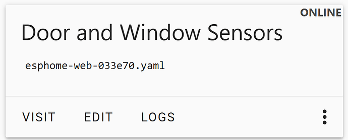

if i add
web_server:
to my code the visit button is shown again
Anybody knows why it behaves like this?
That’s expected behaviour the visit button visits the web page served by the web_server component. You will also get this if you have the fallback AP in a Wi-Fi connected device.
There is an active issue for the web_server: component being loaded without being present in the yaml. This happens when wifi is enabled with captive_portal: also enabled, which is the default.
It should be fixed in 2025.6.

Fix is in 2025.6:
