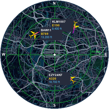

It is now a self-contained ESPHome real time flight radar. It displays nearby aircraft over a local map (centered around your home as defined in Home Assistant), smoothly updates their positions, and rotates each plane icon according to its heading. Tapping a plane or its label opens a details screen with its callsign, airline, route, aircraft type, altitude, speed, and flight times.
EchoEar Flight Radar
The range, units, runway visibility, screen brightness, battery status, touch inputs, and diagnostics are all exposed as Home Assistant entities.
