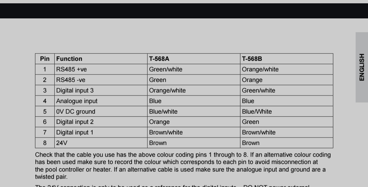

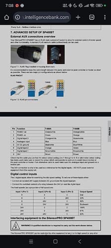

If your pump has another port for interfacing like a rj45 that would probably be way easier than dealing with Bluetooth. Noting higher voltage control logic would need handling.
https://cdn.intelligencebank.com/au/share/BnKJ1e/JnpjZ/ovJly/original/SilensorPro_BT_IM

Vendor feedback: they aren’t aware of any initiative to connect the pump using bluetooth except the official mobile apps, and also suggest to use RJ45 port…
Take this as a grain of salt as I am a protocol and reverse engineering rookie and speculating, but it could be that the pump uses rs485 modbus for onboard communication (two way half duplex?).
The onboard Bluetooth module might convert to this when a bluetooth command is sent/received. The same protocol might be available on the rj45 rs485 wires.
I’ve never used modbus so wouldn’t know how to confirm.
It would be interesting to see the mainboard and where the Bluetooth module is. You might be able to intecept something.
If it uses modbus, it’s pretty straightforward. It would be weird if they give wiring scheme but not communication parameters…
From a skim, they only describe controlling pump speed via the analogue and digital inputs.
There is no information on what is available over the RS485 comms, where other data or controls (e.g. errors, schedules, priming speed) may exist.
My assumption is that features exposed in the app are likely also available on this port.
It wouldn’t ask too much effort to try with modbus approach. With RS485-USB converter and freeware modbus scanner it would be job of minutes…
