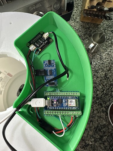

ESPHome Hydroponic Tower Controller Code
I’m configuring a controller for my hydroponic tower and figured I’d share some of the ESPHome code for the sensors to give you a nice flat curve that can read for automations. Using a sliding window I found that getting a 30 minute average reading brought it all together. Anything more was too chaotic of a sample rate. I have the Water Level sensor dialed in, I will likely follow suit with the nutrient sensor but I just haven’t gotten there yet. Hopefully this helps someone out.

Here is a picture of the controller.
