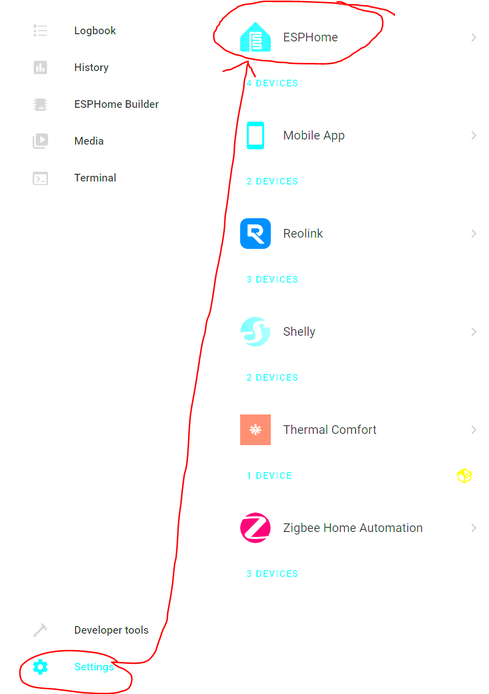

go to “settings” and click the word “esphome”
delete the device by clicking on the 3 dots and then “delete”

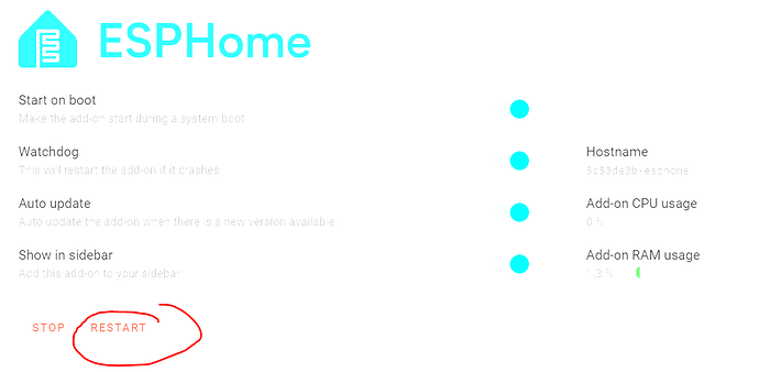

Click “settings” then “add-ons”
click “esphome device builder”
click “restart”

Couple points to note.
  • I did not lose any history using this method
  • This process is stupid AF, but it works.
  • My final code looks like:
wifi:
  ssid: !secret v20internal
  password: !secret v20internal_password
  manual_ip:
   static_ip: 192.168.20.31
   subnet: 255.255.255.0
   gateway: 192.168.20.1
   dns1: 192.168.20.1
Hm…
I did change IP quite a few times before and i never complicated like that. I just insert “use_address…”, flash it, when done (when you get those violet colored messages) i click “stop” to re-enter editor, delete (or comment out) “use_address” line, save&close editor, refresh browser’s page and voila. It also always appears online in esphome devices, also all sensors come back, i never deleted and re-added any of my devices (and i have over 40 of them).
