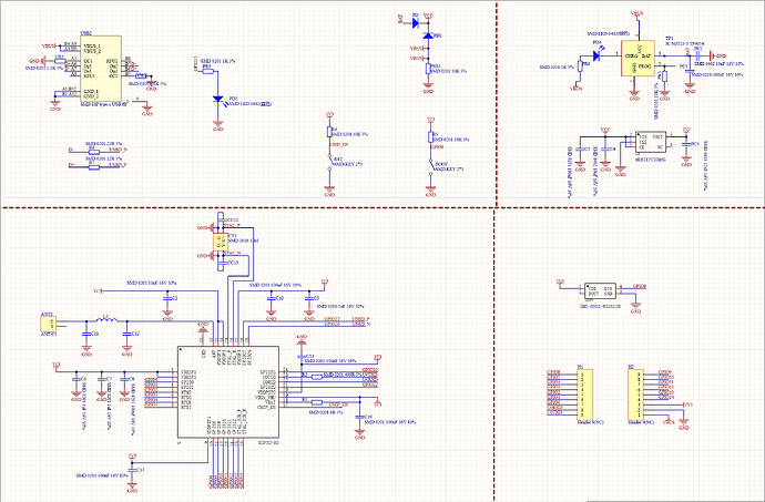

As stated above it is an esp32-h2 Super Mini. It looks exactly like ESP32-H2 Super Mini Development Board Details, Pinout, Specs . It was purchased from https://www.aliexpress.us/item/3256807802657001.html
Alleged schematic, from https://ziliao.nologo.tech/无名科技Nologo资料/ESP32开发板/ESP32-H2%20Supermini+HXB资料/SuperMini-H2原理图.png
Try setting hardware_uart: USB_SERIAL_JTAG, it looks like the default for H2 is not set.
