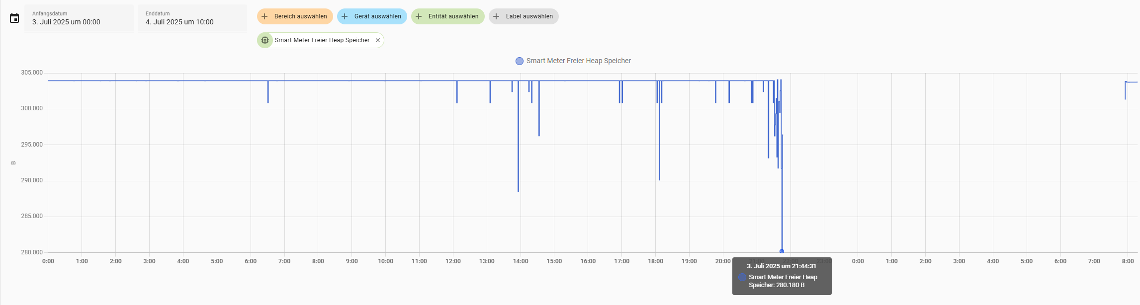

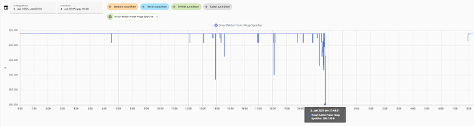

I am seeing exactly the same issue, the device is powered on, but it seems to lose all connectivity, with the Ethernet port not communicating with the switch.
You’ll need to connect a usb/serial cable to it and check the console logs to see why it’s disconnecting
Will do, see what it shows
Also if you find its crashing Troubleshooting — ESPHome
I can’t see logs because serial logging is disabled (logger → baud_rate = 0).
If I remember correctly, I had to do that because I am using both UARTs for my SML sensors and my ESP32 didn’t start and was in a boot loop.
If you can’t get logs, it will be nearly impossible to figure out what is wrong. You have some choices:
  1. Find another way to have the device communicate to you what is going on.
  2. Put in a pre-emptive reboot. Once a day at 04:00 have it reboot itself.
  3. Use other techniques to figure out if the device is completely not responding or the network connection is just down.
  4. Add additional sensors to see the health of the node before it stops responding. I track the free memory on mine.
I have a node running something else that is somewhat problematic and it would regularly go out to lunch. I added a reboot timer to it and it can now go months without failing. I am in the process of moving it to esphome to have more control over the firmware to get a more permanent solution.

@nikop with the increased watchdog timeout it took a bit longer now than before for the crash to appear.
The “Reason for last reset”-sensor shows “Unknown”, but for the free heap sensor I have the following diagram which shows me a spike down right before the device is not reachable anymore:
I suspect it is memory and I’ll try out your part 2, memory guard approach.
