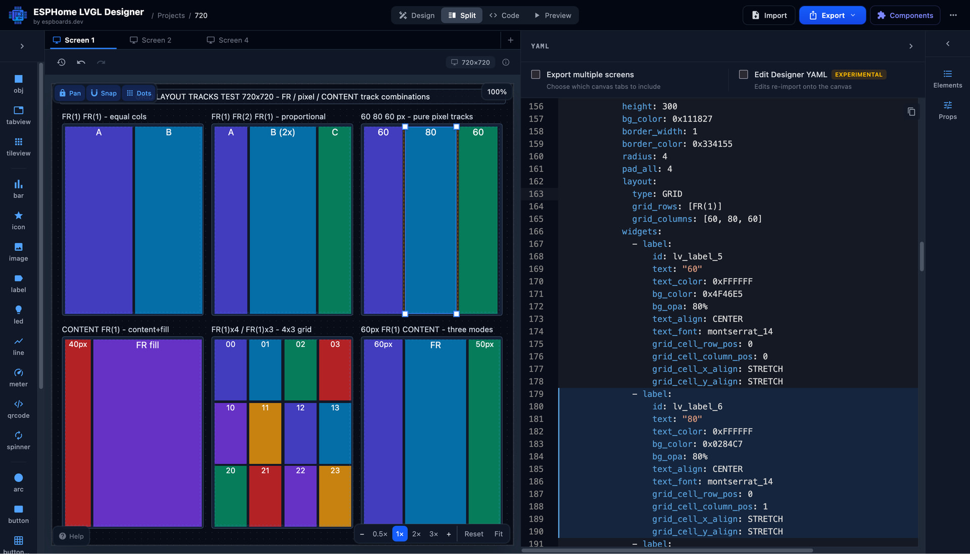

Biggest change: new Split/Code modes with an improved YAML editor - side by side with the canvas, feels more like a code sandbox now.
Another big one: your esphome device config yaml (board, wifi, sensors…) is now supported inline and never touched - only the lvgl: block gets regenerated. An experimental toggle also lets you hand-edit the lvgl block and re-import live.

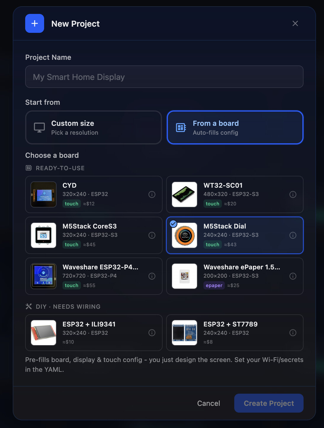

Also new: board presets. New Project now has a visual board gallery - pick your board and the display, touchscreen and hardware config is filled in for you as a full preset, or just go with a custom size like before.

It looks like crowpanels are not supported out of the box. But if you have the parameters for ESPHome, it should be no problem. In the designer you can create a project with a custom display size, and color order.
