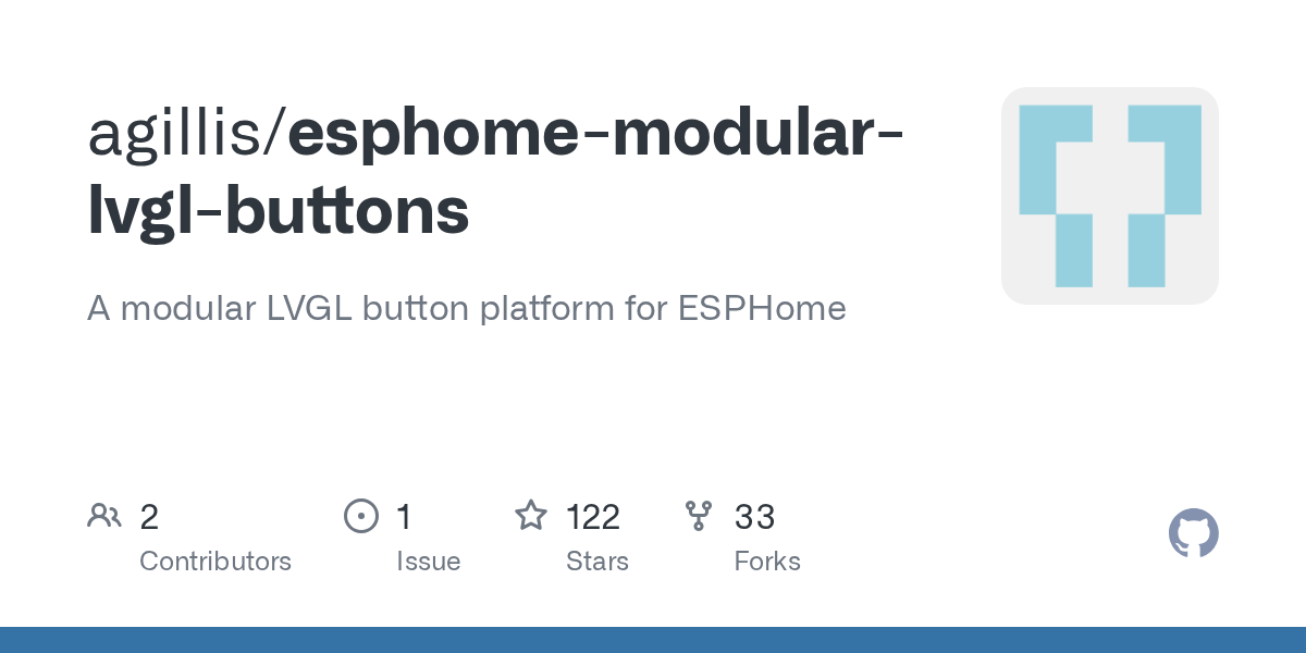

This guy has developped an interesting set of templates that, if standardized, would go a long way to simplifying the task of binding HA devices to LVGL elements
Yes, I have step by step instruction in that git repo on how to do it. Including installing that libary
Yes that’s a nice one. I think mine is a bit more simple to use. Just one line of yaml to create a button and link it HA.
