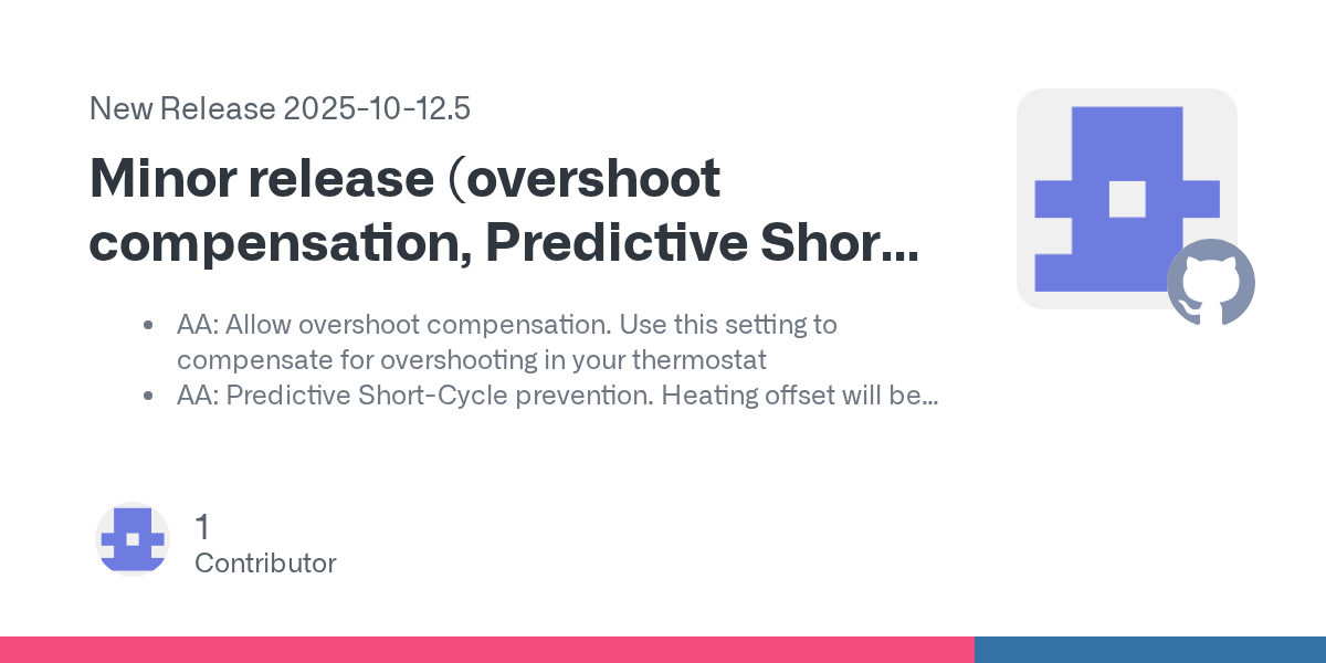

New release with some additions for AA
- AA: Allow overshoot compensation. Use this setting to compensate for overshooting in your thermostat
- AA: Predictive Short-Cycle prevention. Heating offset will be raised by 0.5c when delta between requested and actual feed temp is above 1.0c for the min duration of 4 minutes. This mode is always enabled in Auto Adaptive. In fixed flow heating it can be enabled manually via the switch. the
High Delta detection durationis editable [1m-5m, default 4m] - AA: Only enforce saturation prevention when in active heating/cooling
- AA: Implement dual heating slope for heating. When it gets cold (
< 5c) an additional factor is multiplied with the slope. Setting can now be set in steps of 0.05c - AA: Allow adjustable min flow temp for heating. Override if you are hitting min output capacity during mild weather. [24.0c - 40.0c, default: 25c]
- Add floor dry up, cool compensation curve mode (only works for ftc7+)
- AA: Widen dead zone for UFH profiles during the night
