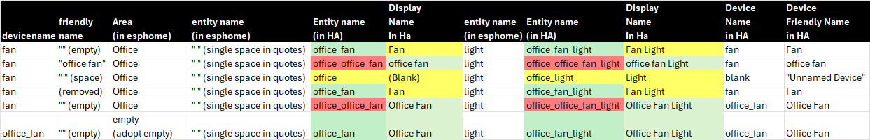

I’d like to share my experiments, and hopefully someone can recommend a more proper way. Let me be specific:
I have an Office Fan (I also have a bunch of fans, each I’d like to name).
The fan has (among others) a light domain and fan domain entity.

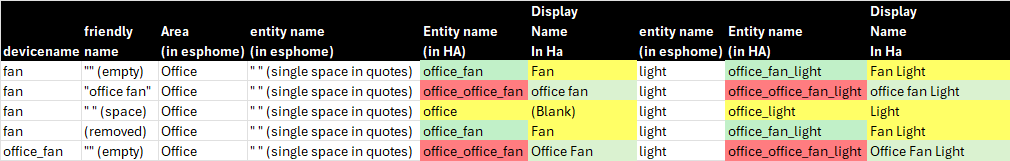

My desire is that the device be Office Fan (so I can find it in esphome builder), but in particular that the entities be:
fan.office_fan
light.office_fan_light
I can get that with the trick in lines 1 and 4 of using a single space for the esphome attribute name, and using an empty or removed friendly name for the device. But when I do that, I get a display name in HA that is simply “Fan” and “Fan Light”.
No, I don’t care that it is implied by an associated area, when I have it pop up on a dashboard as a fan being on, I want it to say “Office Fan Light” not “Fan Light”.
So the best I can do now is use line 1 (or 4), then manually override the display names that HA uses. And this leaves the device name also confusingly just “Fan”.
Is there any way I can do this without manually changing every single entity and/or device name manually? That just seems so wrong, so I am hoping I am missing something.

Well, I may have it wrong in the OP. I’m not sure it is new, as I found I made a change in a template.
One nice thing in esphome is you can declare an area. I had added that to my esphome yaml, and I think that drives a big difference as indicated on line 6 now added:
If I have esphome NOT include area, and make sure area is blank upon adoption into HA, then the entity names only get one “office”, AND the display name is right, I just have to then manually add the area later and NOT recreate ID’s after the area is added.
So I think I sort of can get what I want except I have to not have esphome pass in area, and I need to be very careful not to recreate ID’s once added.
