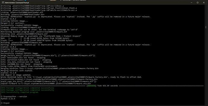

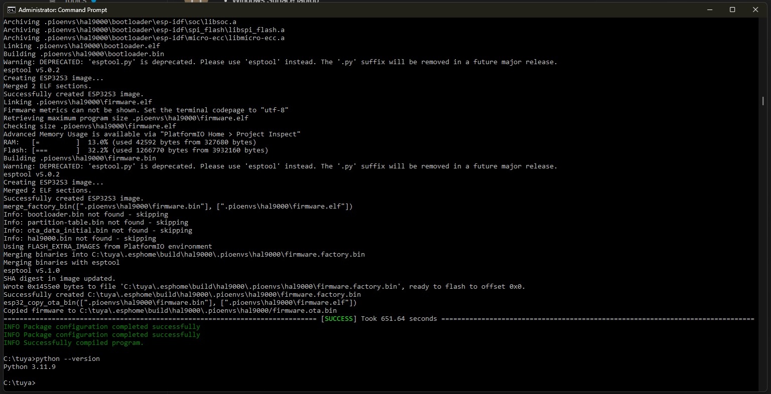

I got it working using windows. I needed to install python 3.11.9 as I couldn’t get it to work with the current release. Also git needs to be installed (as per the link from my previous post) and its location in your path.
Next you need to make sure there is no space in your platformIO path or you will get a corresponding error. see : Error: Detected a whitespace character in project paths - #7 by xumixu - PlatformIO IDE - PlatformIO Community you can set a (Windows) environment variable “PLATFORMIO_CORE_DIR ” to change the directory to be used.
First compile took a long time for tools installation probably due to virus/malware scanning in the background.

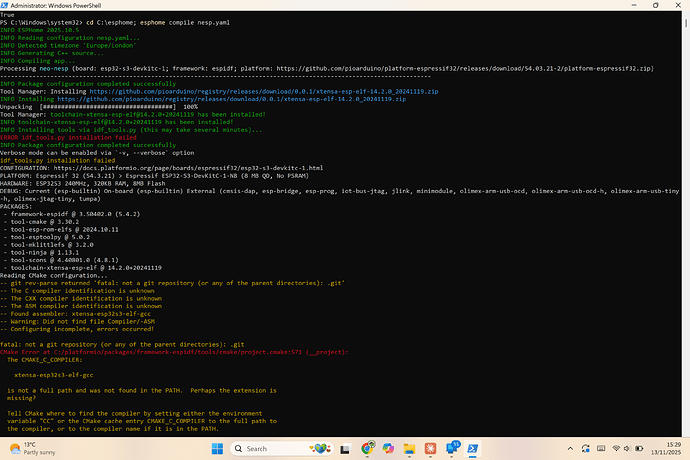

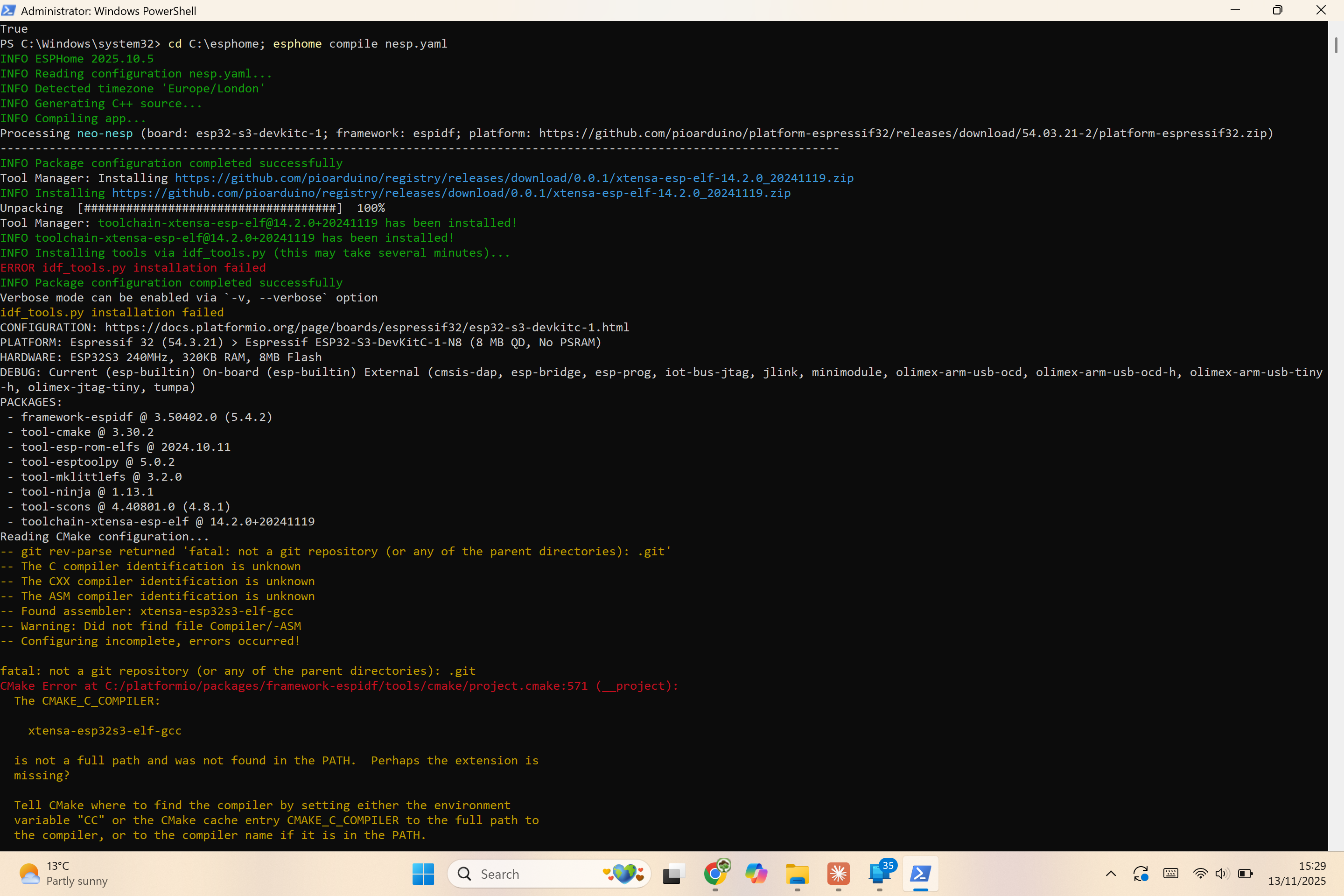

I’ve followed all your suggestions on a fresh Windows Surface Pro:
What I Did (Following Your Steps):
:white_check_mark: Python 3.11.9 - Installed from python.org :white_check_mark: Git - Installed and verified in PATH (git version 2.51.2.windows.1) :white_check_mark: PLATFORMIO_CORE_DIR - Set to C:\platformio (no spaces) :white_check_mark: Windows Defender - Disabled real-time protection and added exclusion for C:\platformio :white_check_mark: ESPHome - Installed via pip (esphome version 2025.10.5)
The Error I’m Getting:
Despite following all your steps, compilation consistently fails with:
INFO Installing tools via idf_tools.py (this may take several minutes)...
ERROR idf_tools.py installation failed
Then CMake errors:
CMake Error: The CMAKE_C_COMPILER (xtensa-esp32s3-elf-gcc) is not a full path
and was not found in the PATH.
What I’ve Discovered:
The root issue appears to be that the pioarduino toolchain ZIP is corrupt - when downloaded, it only contains package.json and tools.json, with no actual compiler binaries.
I can see PlatformIO trying to download:
https://github.com/pioarduino/registry/releases/download/0.0.1/xtensa-esp-elf-14.2.0_20241119.zip
The download shows 100% complete, but when extracted, there are no binaries - just metadata files.
What I’ve Tried to Fix It:
  1. :white_check_mark: Manually downloaded the official Espressif toolchain from GitHub
  2. :white_check_mark: Extracted it to C:\platformio\packages\toolchain-xtensa-esp-elf
  3. :white_check_mark: Verified the compiler exists at .../bin/xtensa-esp32s3-elf-gcc.exe
  4. :x: BUT - PlatformIO keeps re-downloading and overwriting with the broken pioarduino version
Even when I lock the directory or add the toolchain to PATH, PlatformIO insists on downloading the corrupt pioarduio version during compilation.
Questions for You:
Since you got it working, could you help me understand:
  1. What ESPHome version did you use? (I’m on 2025.10.5)
  2. What does your toolchain directory contain? Can you check:
   dir C:\platformio\packages\toolchain-xtensa-esp-elf\bin
Does it have xtensa-esp32s3-elf-gcc.exe?
  1. Did you modify the platform: line in nesp.yaml? Mine currently points to:
   platform: https://github.com/pioarduino/platform-espressif32/releases/download/54.03.21-2/platform-espressif32.zip
  1. Did you have any previous ESP-IDF or PlatformIO installations that might have cached working toolchains?
  2. Can you share the output from when your compilation succeeded? Specifically the “Installing tools via idf_tools.py” section?
  3. Did you do anything special to prevent PlatformIO from overwriting the toolchain?
What Worked on Your System?
I’m particularly interested in:
  • Whether the pioarduino toolchain downloaded successfully for you
  • If you had to manually fix anything with the toolchain
  • What your full compilation output looked like
I’ve tried this on three different devices now (Windows PC, Surface, Home Assistant) and all hit the same corrupt toolchain issue. Since you got it working, there must be something different about your setup or approach.
Any help would be greatly appreciated! This has been going on for days now and I’m at my wit’s end.
Thanks again for your help!

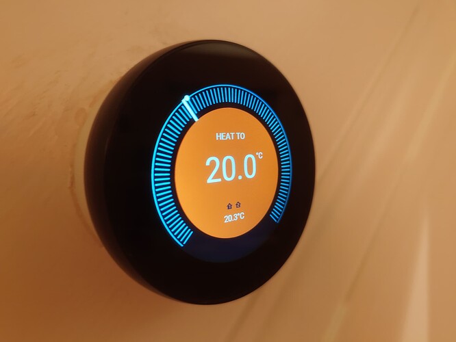

EDIT - fully working - this is great!
Using a 3D printed mount which hides the wires and I soldered 5V+GND directly to the unused pads on the breakout board so I can avoid the visible USB cable sticking out the side.
