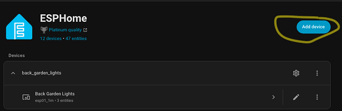

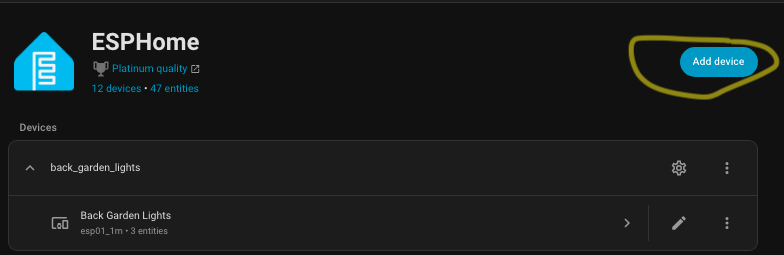

Have you re-added the device to the ESPHome integration?
No, because it is still there.
