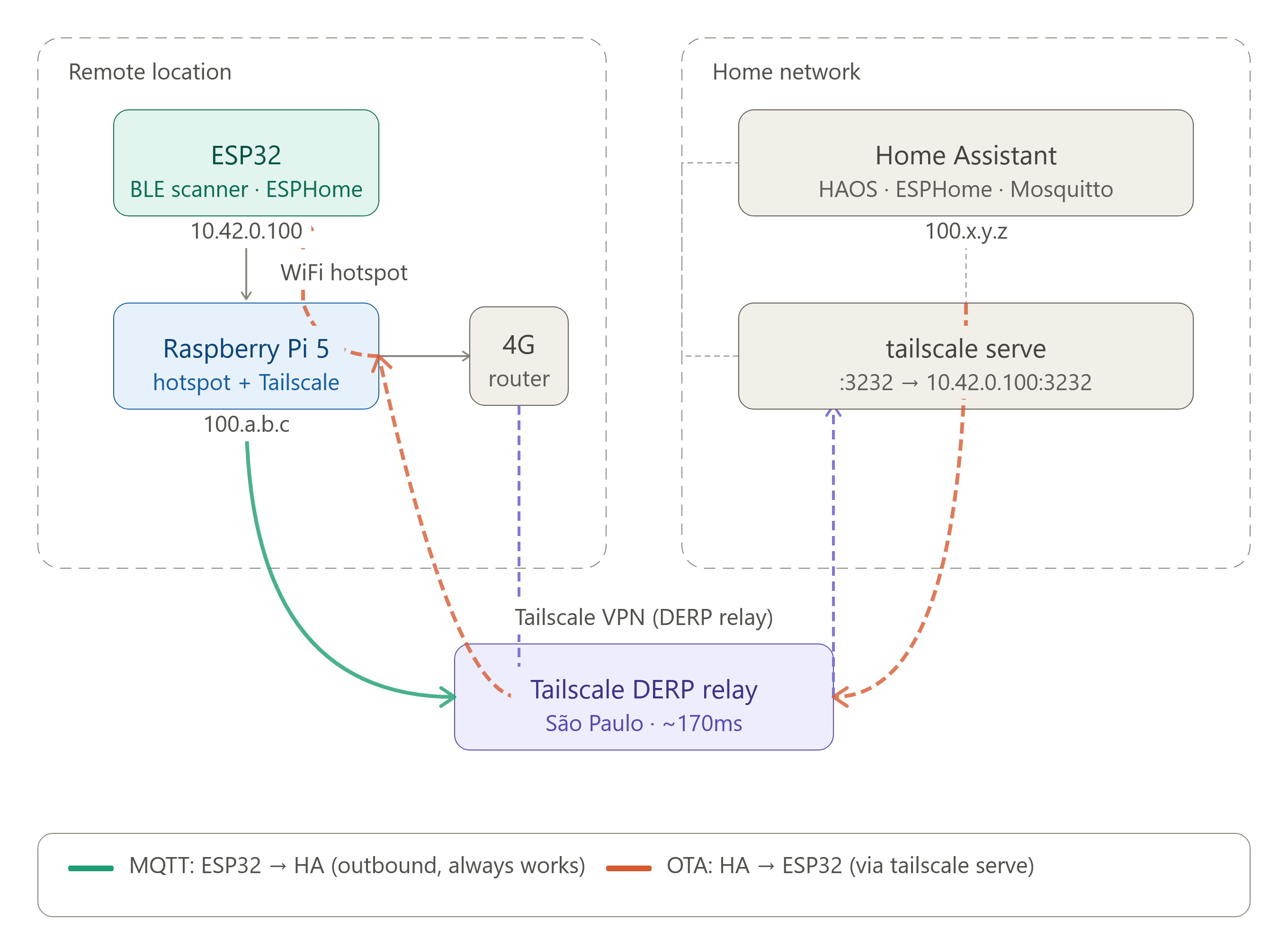

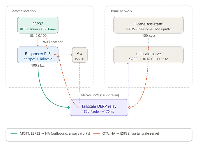

The architecture:
  • ESP32 runs ESPHome with MQTT (no native API). Static IP 10.42.0.100 on the
    Pi hotspot subnet.
  • Raspberry Pi 5 creates a WiFi hotspot for the ESP32, connects to the internet
    via a 4G router, and runs Tailscale (Tailscale IP: 100.a.b.c).
  • Home Assistant (HAOS on Proxmox) runs ESPHome and Mosquitto.
    Tailscale IP: 100.x.y.z.
  • Tailscale DERP relay (São Paulo) bridges the connection — the 4G router uses
    symmetric NAT which blocks direct peer-to-peer Tailscale connections.
Everything worked perfectly: MQTT sensor data flowed from the ESP32 to HA, automations
fired, BLE beacons were detected. Except one thing: OTA firmware updates were
impossible.

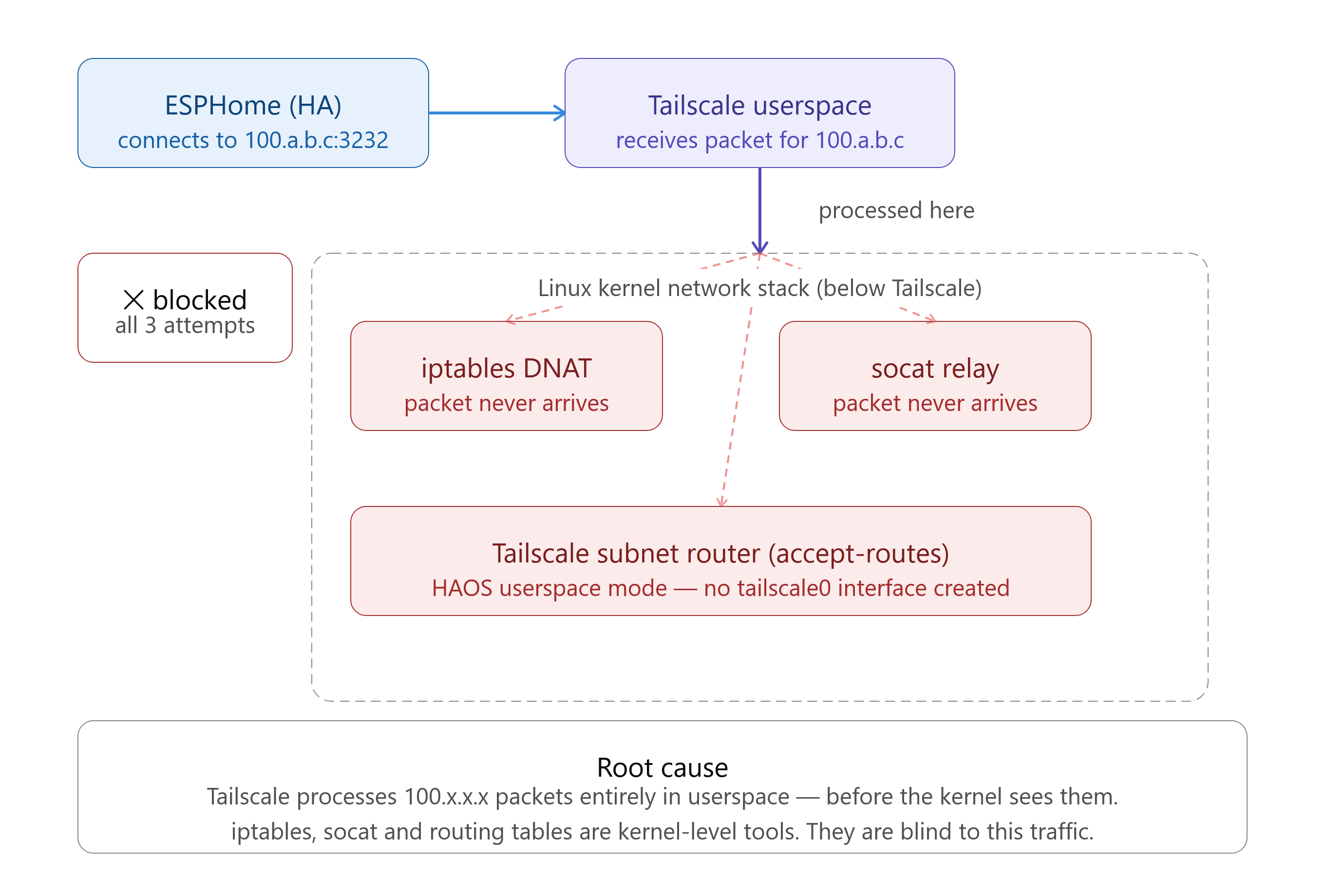

What I Tried That Didn’t Work
:cross_mark: iptables DNAT
sudo iptables -t nat -A PREROUTING -i tailscale0 -p tcp --dport 3232 \
  -j DNAT --to-destination 10.42.0.100:3232
Why it fails: Traffic arriving on a Tailscale IP (100.a.b.c) is processed by
Tailscale’s userspace networking stack before it ever reaches the Linux kernel
network layer. iptables never sees it. The DNAT rule is in the right place for
normal traffic — but completely invisible to Tailscale-destined packets.
Confirmed with tcpdump -i tailscale0 port 3232: the SYN packet arrives on the
Tailscale interface, but socat and iptables never receive it.
:cross_mark: socat relay
socat TCP-LISTEN:3232,fork,reuseaddr,bind=0.0.0.0 TCP:10.42.0.100:3232
Why it fails: Same fundamental problem. socat listens on the Linux network
stack. Tailscale consumes the packets before they get there.
:cross_mark: ESPHome use_address override
wifi:
  use_address: 100.a.b.c  # Pi's Tailscale IP
Why it fails: use_address works for native API connections, but for MQTT-based
devices ESPHome uses the IP from the MQTT discovery response — which is the ESP32’s
actual hotspot IP (10.42.0.100), not the Pi’s Tailscale IP.
:cross_mark: Tailscale subnet router
sudo tailscale set --advertise-routes=10.42.0.0/24
Approved in the Tailscale admin console. The route appeared correctly on the Pi.
Why it fails: HA’s Tailscale add-on runs in userspace networking mode inside
a Docker container on HAOS. In this mode, no tailscale0 interface is created on
the host. Even with accept_routes: true in the add-on configuration,
ip route show table 52 shows nothing. The subnet route is advertised but HA
cannot use it to reach 10.42.0.x.
The Root Cause
All four approaches fail for the same reason:
When a packet is destined for a Tailscale IP address (100.x.x.x), Tailscale’s
userspace stack intercepts and processes it before the Linux kernel network stack
sees it. Any tool that operates at kernel level — iptables, socat, routing tables —
is completely blind to this traffic.

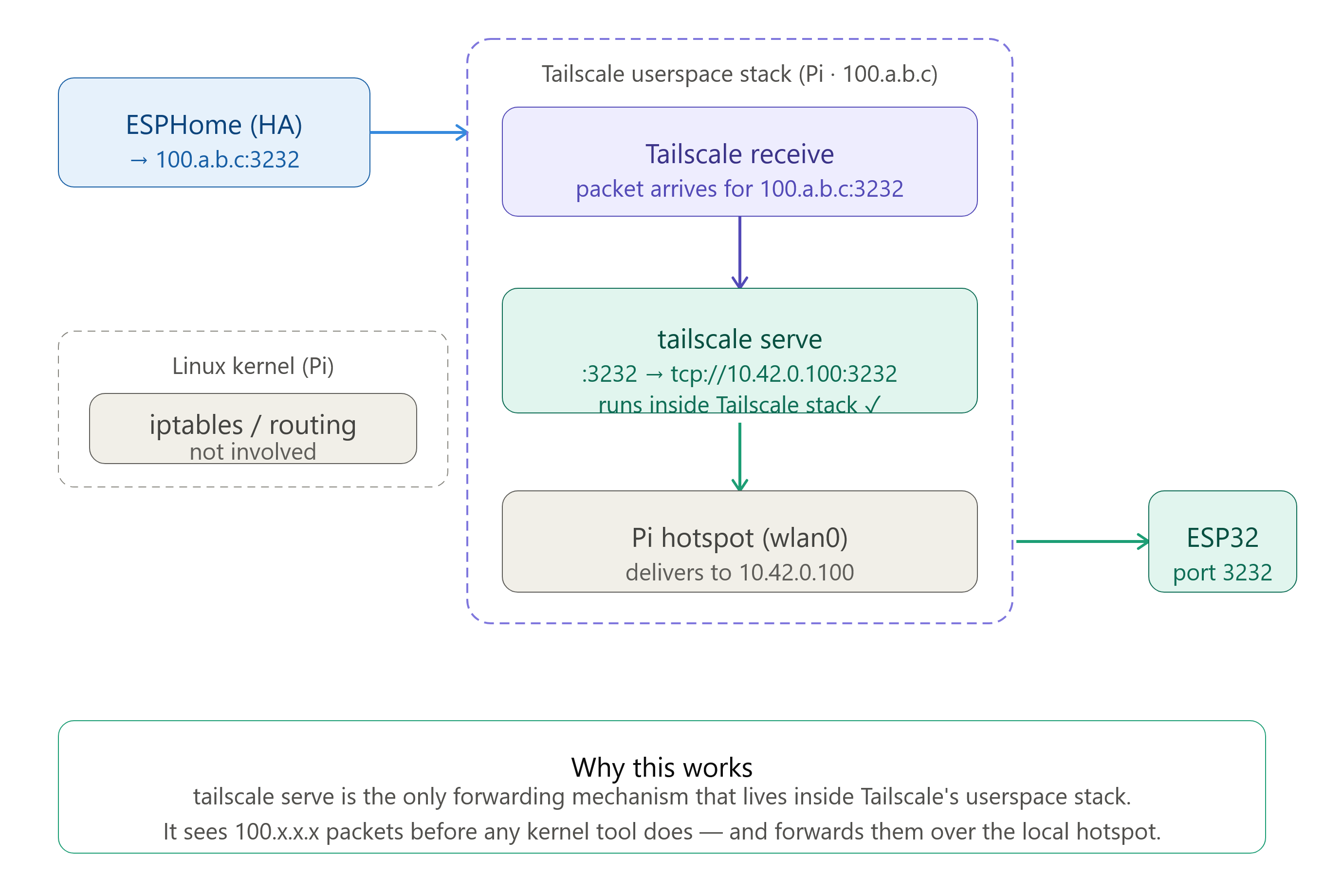

The Solution: tailscale serve
tailscale serve is Tailscale’s native port forwarding feature. Because it operates
within Tailscale’s own userspace stack — not at the kernel level — it actually
intercepts the traffic and can forward it.
On the Raspberry Pi, run:
sudo tailscale serve --bg --tcp 3232 tcp://10.42.0.100:3232
  • --bg runs it as a background service, persistent across reboots
  • --tcp 3232 listens on the Pi’s Tailscale IP, port 3232
  • tcp://10.42.0.100:3232 forwards to the ESP32’s static IP on the hotspot
Verify:
sudo tailscale serve status
Expected output:
|-- tcp://your-pi-hostname.tail-xxxxx.ts.net:3232 (TLS over TCP, tailnet only)
|-- tcp://100.a.b.c:3232
|–> tcp://10.42.0.100:3232
After this, ESPHome OTA works with a single click from the dashboard, from
anywhere in the world. No USB cable. No physical access required.

Cellular NAT Behavior
This setup was tested with a 4G MiFi using symmetric NAT — one of the strictest
NAT types. Tailscale falls back to DERP relay servers automatically:
pong from homeassistant (100.x.y.z) via DERP(sao) in 156ms
DERP relay adds ~150–200ms latency (São Paulo for Chile). This is acceptable for
both MQTT sensor data and OTA firmware uploads.
