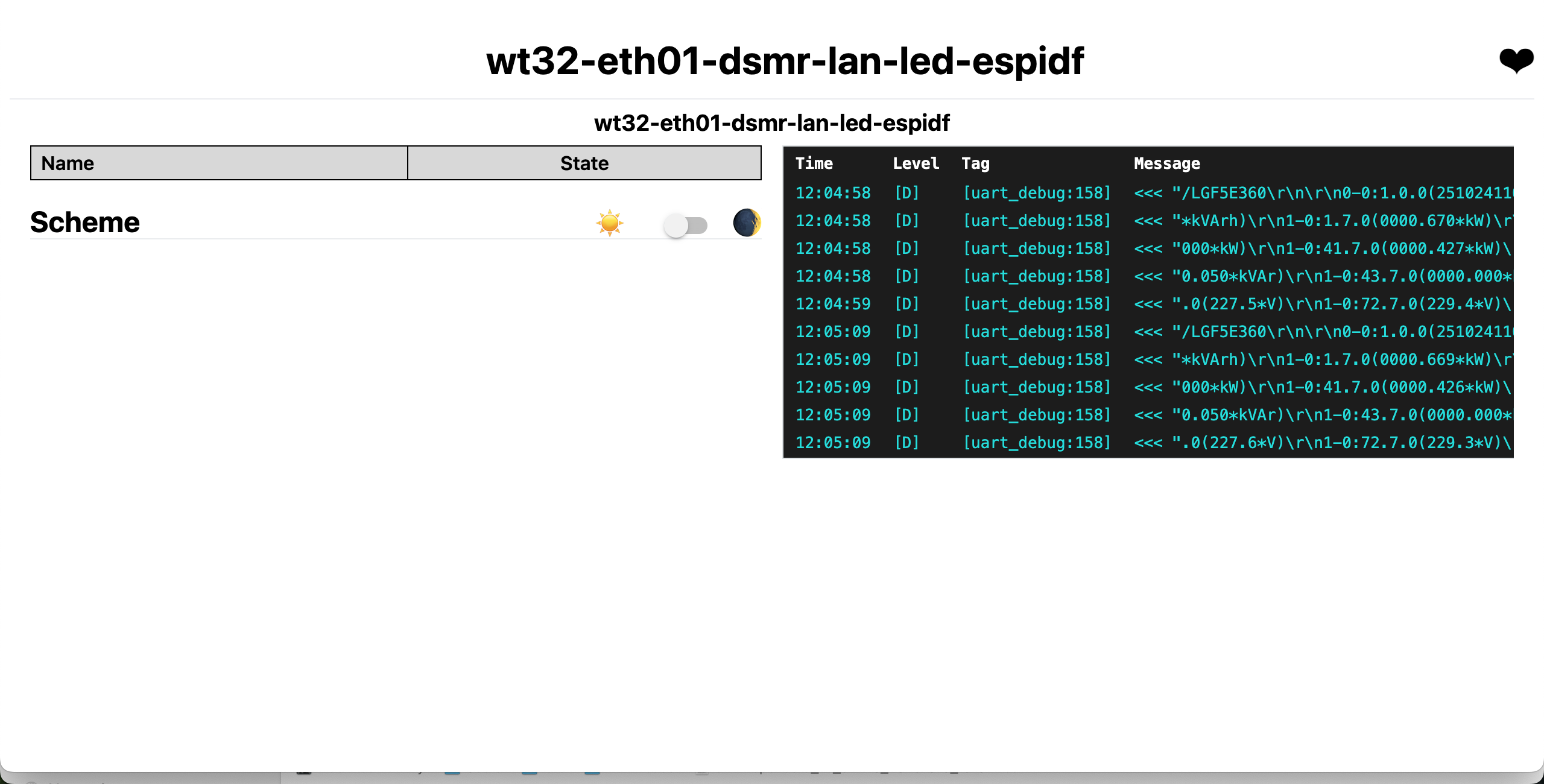

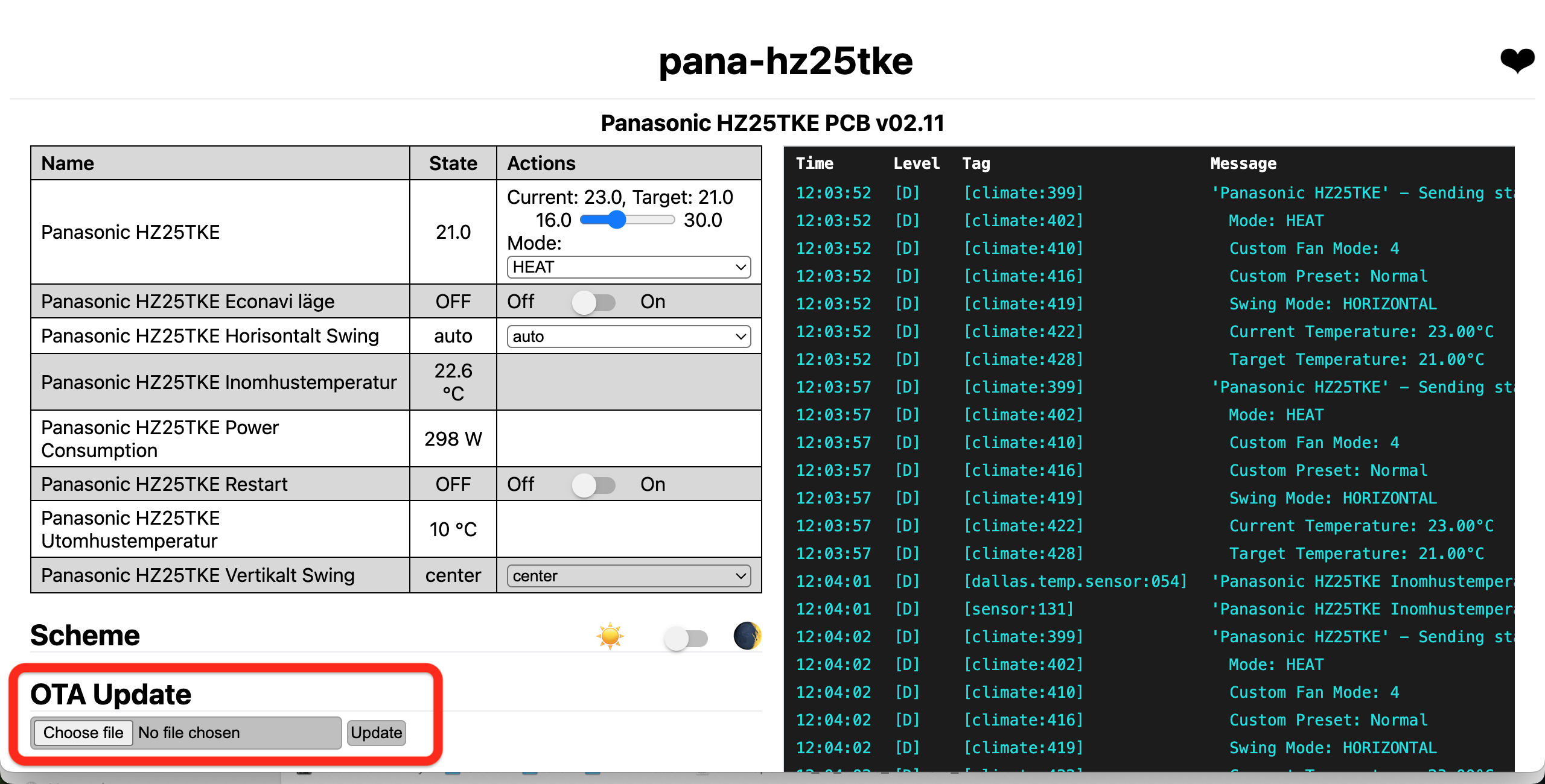

ESPHome OTA upload missing on WT32-ETH01 (Ethernet) but works on Wi-Fi?
When you configure OTA, an upload function normally appears in the device built-in web server when using Wi-Fi on an ESP32 (image 1), but not when using Ethernet on an ESP32 WT32-ETH01 (image 2).
Is that a bug or by design?

Image 1 - ESP32 D1 Mini NodeMCU
Image 2 - WT32-ETH01 - ESP32-WROOM-32 (ESP32-D0WD)
try
ota:
  - platform: esphome
  - platform: web_server
Thanks, that fixed it! :pray:
