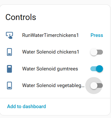

Here is the screen shot of the ESPHome device - showing the three switches and the single button
Is this a bug, expected behaviour or am I just not doing something right.

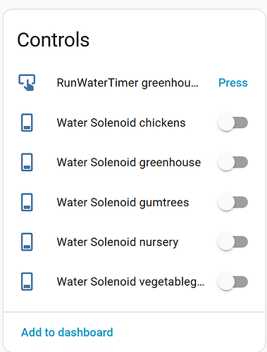

  • I have also done all 5 solenoids so there are more now
I also find it strange that the button - coded to only affect one switch affects all five switches
This is the copy and past from the Activity log in esphome
Orchard6 Water Solenoid greenhouse turned on
9:26:41 PM - Now
Orchard6 Water Solenoid nursery turned on
9:26:41 PM - Now
Orchard6 Water Solenoid chickens turned on
9:26:41 PM - Now
Orchard6 Water Solenoid gumtrees turned on
9:26:41 PM - Now
Orchard6 Water Solenoid vegetablegarden turned on
9:26:41 PM - Now
Orchard6 RunWaterTimer greenhouse changed to January 7, 2026 at 9:26 PM triggered by action Button: Press
9:26:41 PM - Now - Ross

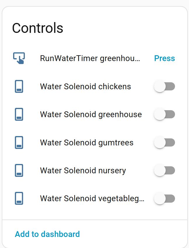

I missed the - on the button
button:
   platform: template
sgould be
button:
  - platform: template
and even better the helpful person who told me this also said - the “validate” button in ESPHome gives you the expanded full yaml , so it shows all the YASML AFTER the includes, expansions and substitutions
  • it was pretty obvious what was happening when I looked at that
That makes no difference for lists with only one member. It was something else.
Tom , First - That was the one change I made, just the single “-” added on to that one line , So it was not "something else " it was the “-”
I assume what it is is that I have five items in the list due to the way packages work -
