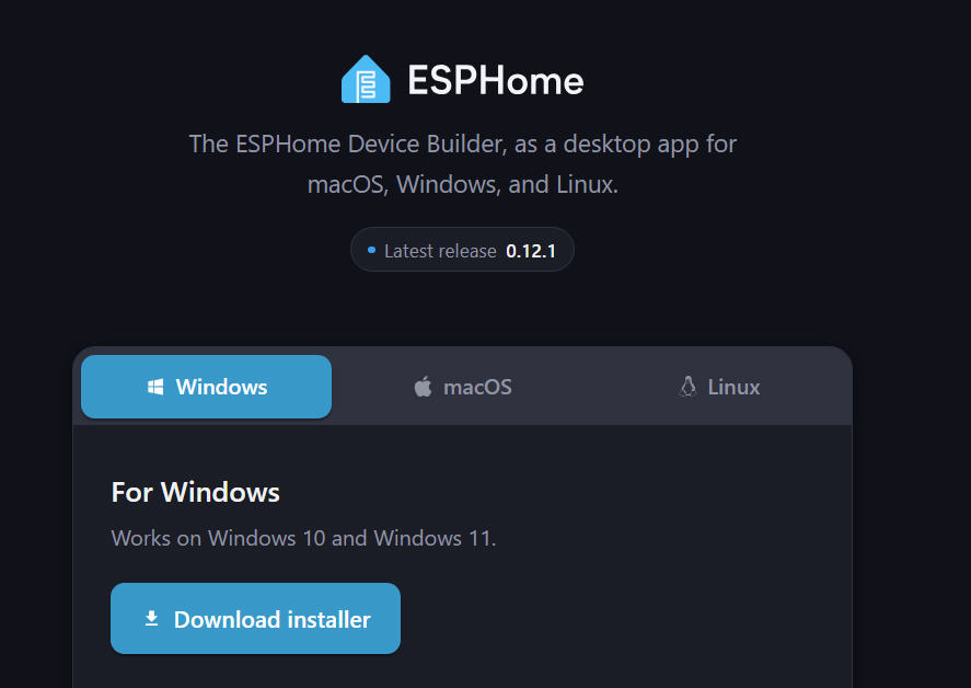

Wait, what? All I need to do is install ESPHome Device Builder on my PC, then use the program on Windows to do my ESPHome installs?
there's options:
-install esphome desktop on windows, do everything from there
-install esphome desktop on windows, the docker or ha addon somewhere else, and pair the windows intall with the docker/ha install and it compiles the builds for you while you use the console from ha/docker install
