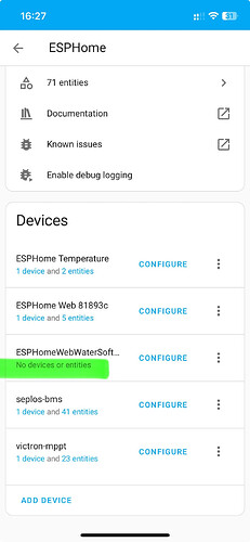

I have an esp32 loaded with esphome and connected to various sensors: two contact sensors and a time of flight sensor. Everything was working fine until today I decided to change the interval update for the time of flight sensor from 10s to 18000s. I updated it wirelessly and when it was done none of the sensors were there. I’ve tried removing it and readding it multiple times and reupdating the esphome yaml multiple times, including removing the encryption but nothing worked.

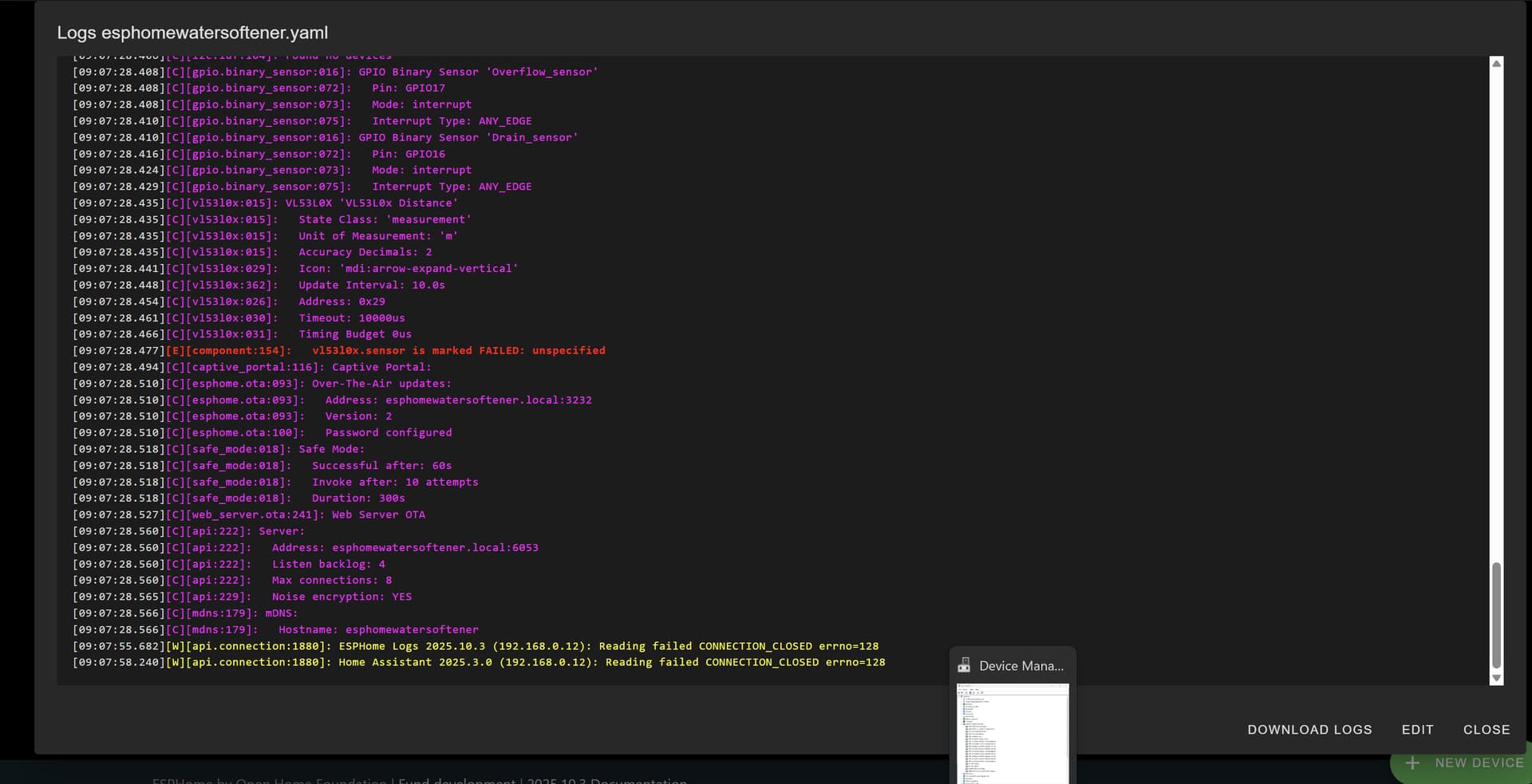

When I look at the device logs I see the sensors working correctly
INFO ESPHome 2025.10.3
INFO Reading configuration /config/esphome/esphome-web-f91e88.yaml…
INFO Starting log output from 192.168.0.226 using esphome API
INFO Successfully resolved esphome-web-f91e88 @ 192.168.0.226 in 0.000s
INFO Successfully connected to esphome-web-f91e88 @ 192.168.0.226 in 0.113s
INFO Successful handshake with esphome-web-f91e88 @ 192.168.0.226 in 0.083s
[08:37:44.297][I][app:185]: ESPHome version 2025.10.3 compiled on Oct 27 2025, 15:55:41
[08:37:44.301][C][wifi:679]: WiFi:
[08:37:44.303][C][wifi:458]: Local MAC: 24:0A:C4:F9:1E:88
[08:37:44.306][C][wifi:465]: IP Address: 192.168.0.226
[08:37:44.313][C][wifi:469]: SSID: [redacted]
[08:37:44.313][C][wifi:469]: BSSID: [redacted]
[08:37:44.313][C][wifi:469]: Hostname: ‘esphome-web-f91e88’
[08:37:44.313][C][wifi:469]: Signal strength: -44 dB ▂▄▆█
[08:37:44.313][C][wifi:469]: Channel: 1
[08:37:44.313][C][wifi:469]: Subnet: 255.255.255.0
[08:37:44.313][C][wifi:469]: Gateway: 192.168.0.1
[08:37:44.313][C][wifi:469]: DNS1: 192.168.0.1
[08:37:44.313][C][wifi:469]: DNS2: 0.0.0.0
[08:37:44.317][C][logger:261]: Logger:
[08:37:44.317][C][logger:261]: Max Level: DEBUG
[08:37:44.317][C][logger:261]: Initial Level: DEBUG
[08:37:44.326][C][logger:267]: Log Baud Rate: 115200
[08:37:44.326][C][logger:267]: Hardware UART: UART0
[08:37:44.344][C][logger:274]: Task Log Buffer Size: 768
[08:37:44.344][C][i2c.arduino:072]: I2C Bus:
[08:37:44.345][C][i2c.arduino:073]: SDA Pin: GPIO21
[08:37:44.345][C][i2c.arduino:073]: SCL Pin: GPIO22
[08:37:44.345][C][i2c.arduino:073]: Frequency: 50000 Hz
[08:37:44.353][C][i2c.arduino:089]: Recovery: bus successfully recovered
[08:37:44.357][I][i2c.arduino:099]: Results from bus scan:
[08:37:44.360][I][i2c.arduino:105]: Found device at address 0x29
[08:37:44.383][C][gpio.binary_sensor:016]: GPIO Binary Sensor ‘Overflow_sensor’
[08:37:44.386][C][gpio.binary_sensor:072]: Pin: GPIO17
[08:37:44.392][C][gpio.binary_sensor:073]: Mode: interrupt
[08:37:44.396][C][gpio.binary_sensor:075]: Interrupt Type: ANY_EDGE
[08:37:44.397][C][gpio.binary_sensor:016]: GPIO Binary Sensor ‘Drain_sensor’
[08:37:44.400][C][gpio.binary_sensor:072]: Pin: GPIO16
[08:37:44.408][C][gpio.binary_sensor:073]: Mode: interrupt
[08:37:44.409][C][gpio.binary_sensor:075]: Interrupt Type: ANY_EDGE
[08:37:44.417][C][vl53l0x:015]: VL53L0X ‘VL53L0x Distance’
[08:37:44.417][C][vl53l0x:015]: State Class: ‘measurement’
[08:37:44.417][C][vl53l0x:015]: Unit of Measurement: ‘m’
[08:37:44.417][C][vl53l0x:015]: Accuracy Decimals: 2
[08:37:44.420][C][vl53l0x:029]: Icon: ‘mdi:arrow-expand-vertical’
[08:37:44.428][C][vl53l0x:362]: Update Interval: 10.0s
[08:37:44.437][C][vl53l0x:026]: Address: 0x29
[08:37:44.441][C][vl53l0x:030]: Timeout: 10000us
[08:37:44.444][C][vl53l0x:031]: Timing Budget 33971us
[08:37:44.466][C][captive_portal:116]: Captive Portal:
[08:37:44.477][C][esphome.ota:093]: Over-The-Air updates:
[08:37:44.477][C][esphome.ota:093]: Address: esphome-web-f91e88.local:3232
[08:37:44.477][C][esphome.ota:093]: Version: 2
[08:37:44.488][C][safe_mode:018]: Safe Mode:
[08:37:44.488][C][safe_mode:018]: Successful after: 60s
[08:37:44.488][C][safe_mode:018]: Invoke after: 10 attempts
[08:37:44.488][C][safe_mode:018]: Duration: 300s
[08:37:44.498][C][web_server.ota:241]: Web Server OTA
[08:37:44.509][C][api:222]: Server:
[08:37:44.509][C][api:222]: Address: esphome-web-f91e88.local:6053
[08:37:44.509][C][api:222]: Listen backlog: 4
[08:37:44.509][C][api:222]: Max connections: 8
[08:37:44.511][C][api:229]: Noise encryption: YES
[08:37:44.516][C][mdns:179]: mDNS:
[08:37:44.516][C][mdns:179]: Hostname: esphome-web-f91e88
[08:37:47.472][D][vl53l0x:310]: ‘VL53L0x Distance’ - Got distance 0.258 m
[08:37:47.476][D][sensor:131]: ‘VL53L0x Distance’: Sending state 0.25800 m with 2 decimals of accuracy
[08:37:51.880][W][api.connection:1880]: 192.168.0.123 (192.168.0.123): Socket operation failed BAD_INDICATOR errno=11
[08:37:51.905][D][api:160]: Accept 192.168.0.123
[08:37:51.912][W][api.connection:1880]: 192.168.0.123 (192.168.0.123): Socket operation failed BAD_INDICATOR errno=11
[08:37:51.946][D][api:160]: Accept 192.168.0.123
[08:37:51.954][W][api.connection:1880]: 192.168.0.123 (192.168.0.123): Socket operation failed BAD_INDICATOR errno=11
[08:37:52.887][D][api:160]: Accept 192.168.0.12
[08:37:52.955][D][api.connection:1383]: Home Assistant 2025.3.0 (192.168.0.12) connected
[08:37:53.000][D][api:160]: Accept 192.168.0.123
[08:37:53.004][W][api.connection:1880]: 192.168.0.123 (192.168.0.123): Socket operation failed BAD_INDICATOR errno=11
[08:37:53.017][D][api:160]: Accept 192.168.0.116
[08:37:53.024][D][api:160]: Accept 192.168.0.116
[08:37:53.033][W][api.connection:1880]: 192.168.0.116 (192.168.0.116): Socket operation failed BAD_INDICATOR errno=11
[08:37:54.135][W][api.connection:1880]: 192.168.0.123 (192.168.0.123): Socket operation failed BAD_INDICATOR errno=11
[08:37:54.143][W][api.connection:1880]: 192.168.0.116 (192.168.0.116): Socket operation failed BAD_INDICATOR errno=11
[08:37:54.147][D][api:160]: Accept 192.168.0.116
[08:37:54.152][D][api:160]: Accept 192.168.0.123
[08:37:54.160][W][api.connection:1880]: 192.168.0.123 (192.168.0.123): Socket operation failed BAD_INDICATOR errno=11
[08:37:54.167][W][api.connection:1880]: 192.168.0.116 (192.168.0.116): Socket operation failed BAD_INDICATOR errno=11
[08:37:54.176][D][api:160]: Accept 192.168.0.123
[08:37:54.184][D][api:160]: Accept 192.168.0.116
[08:37:54.188][W][api.connection:1880]: 192.168.0.116 (192.168.0.116): Socket operation failed BAD_INDICATOR errno=11

I see this error (192.168.0.12 is HA)
[W] [api.connection:1880] Home Assistant 2025.3.0 (192.168.0.12): Reading failed CONNECTION_CLOSED errno=128

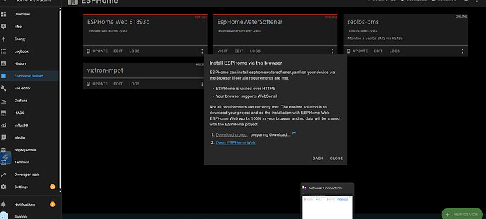

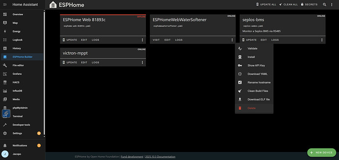

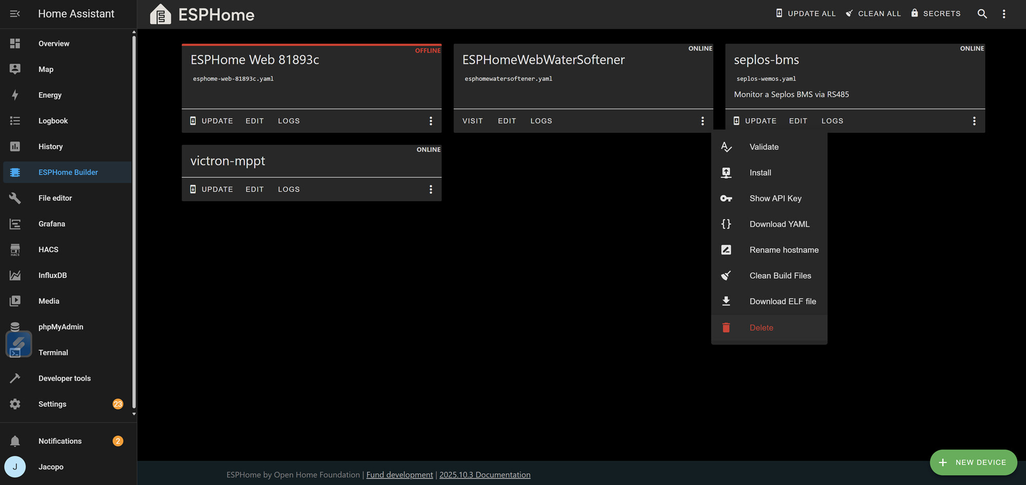

I’ve tried deleting the device from EspHome builder and readd it from scratch, same issue
Here’s what I’ve done
clicked “delete” here

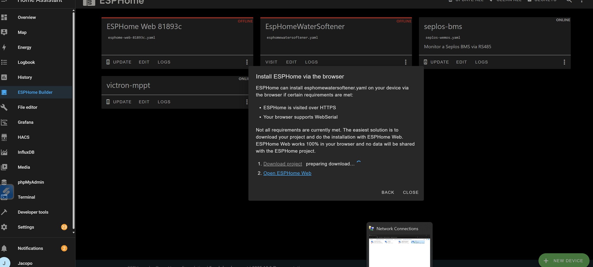

clicked “add new device” and download the bin file
open EspHome and select “install”, not “prepare for first use”
click connect, press the boot button on the device and then install, after 2 minutes it shows as done

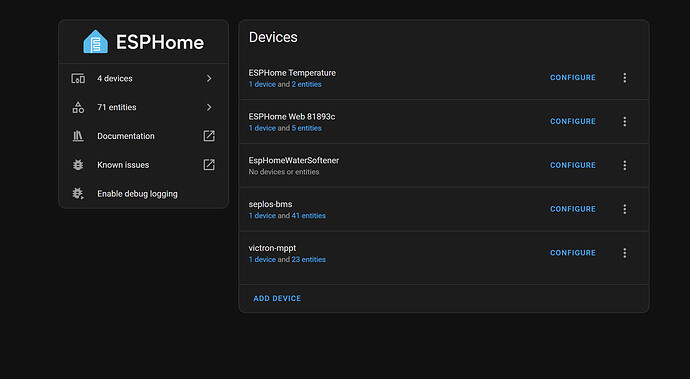

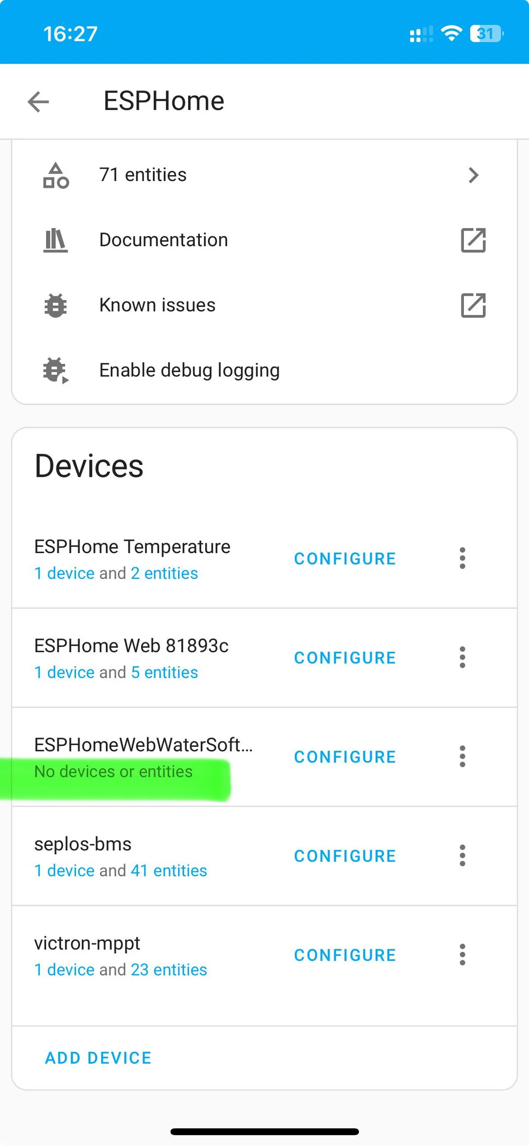

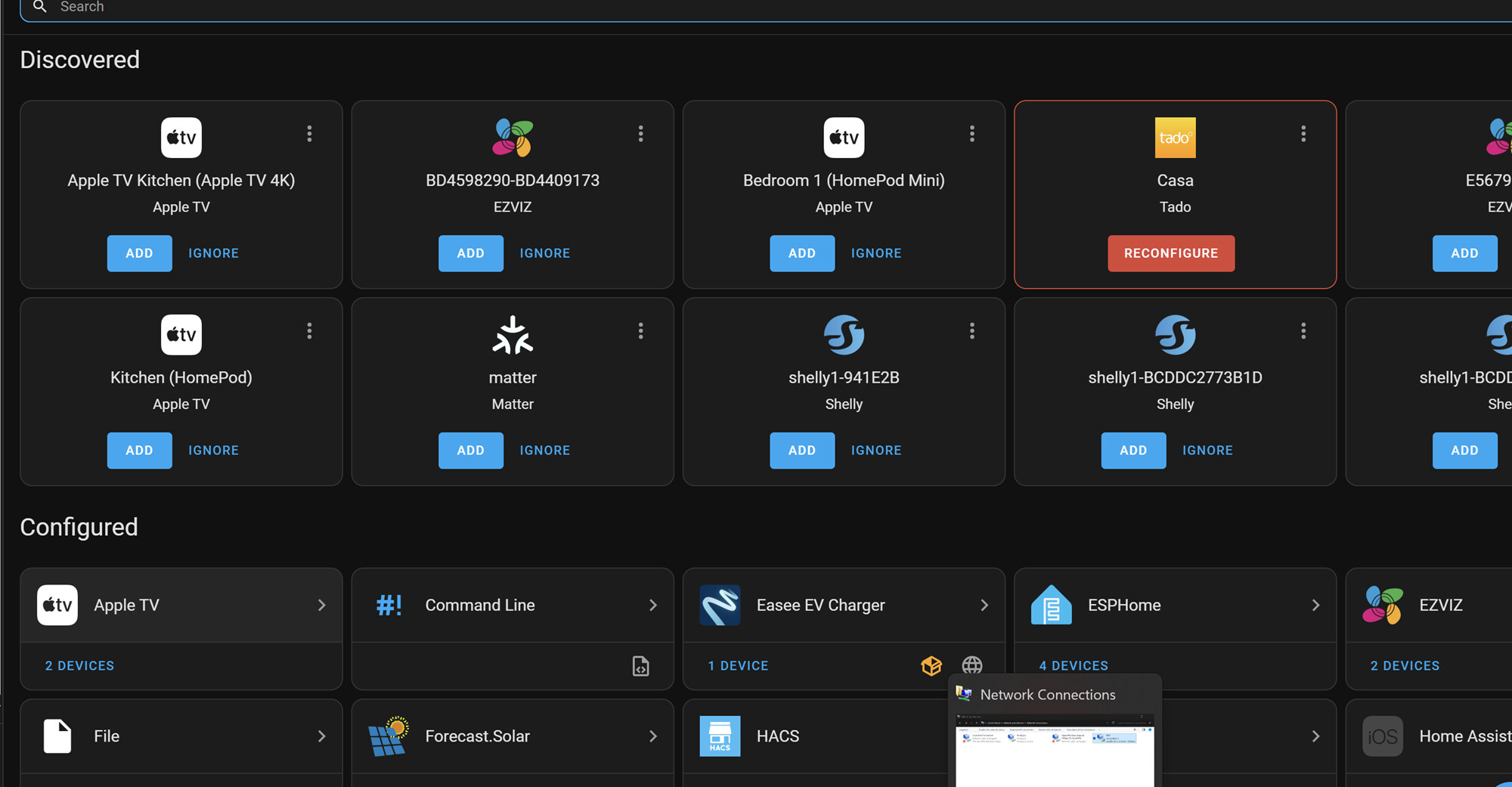

The device was showing here with the “reconfigure” button highlighted, so I clicked it

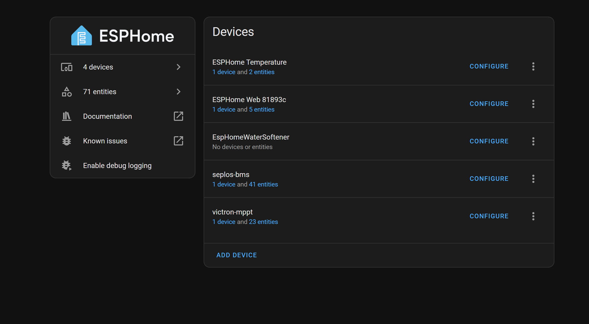

it shows like this

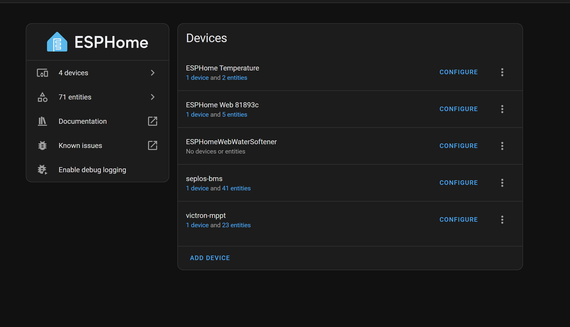

mmm, wait, let me add the sensors in the yaml and reinstall wirelessly… no, still not showing any sensors
and this is what the logs show
Update, I updated Home Assistant and it just works fine now
