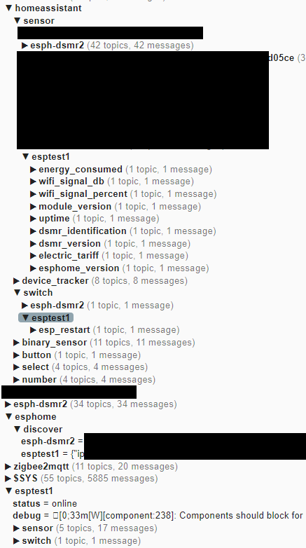

And the MQTT side looks fine with all sensor/switch having a config entry for under homeassistant topic:

In the MQTT explorer the topics and entries seem fine, everything is there. Adding
