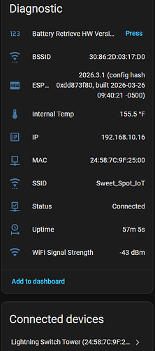

Both hardware profiles also implement a consistent connection status LED pattern: fast blink = no WiFi, solid = WiFi but no API, slow sine-wave glow = fully connected.

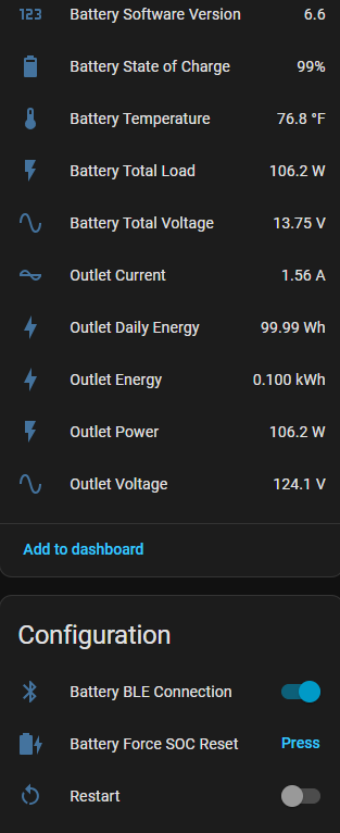

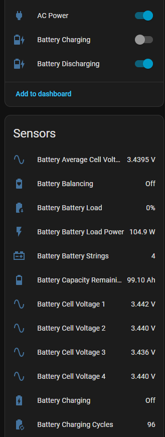

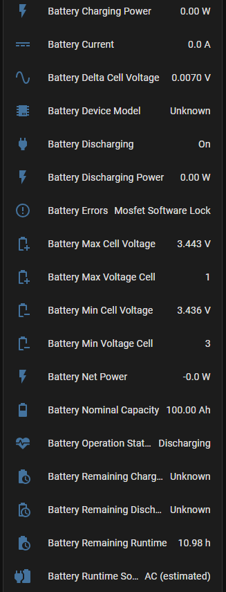

I have added an offline battery monitor (Automatic lightning disconnect) and more functions to the timed light. Comes with new 2 addons, battery management sensors and jbd-bms-ble from syssi.
substitutions:
  device_name: lightning_switch_tower
  friendly_name: Lightning Switch Tower
  name_no_dashes: lightning_switch_tower
  restore_mode_setting: RESTORE_DEFAULT_ON
  device_description: "SwitchBot Outlet Power Monitor - switchbot_outlet_mini"
  bms_id: "bms0"
  bms_name: "Battery"
  bms_mac_address: "A5:C2:37:37:D0:16"
  max_battery_current: "100"  #Amps
  inverter_efficiency: "0.85"
external_components:
  - source: github://syssi/esphome-jbd-bms@main
packages:
  common: !include esphome-miniplug-framework/common/esp_common.yaml
  hardware: !include esphome-miniplug-framework/hardware/switchbot_miniplug_W1901400.yaml
  function: !include esphome-miniplug-framework/functions/miniplug_battery_backup.yaml
  bms0: !include esphome-miniplug-framework/addon/jbd_bms_ble.yaml
  battery0: !include esphome-miniplug-framework/addon/battery_power_analysis.yaml
