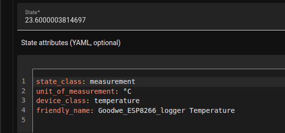

The value of id(gw_registers)[42] is 236, and I want to display it as 23.6. In Home Assistant this seems to work correctly, but when I look under state in the developer tools, I see 23.6000003814697.
Screenshot from HA

23.6 isn’t exactly representable in a 32 bit float.
The developer tools state is correctly reporting the actual value; the user interface is displaying it in a human-friendly way as desired, so what’s the problem?
